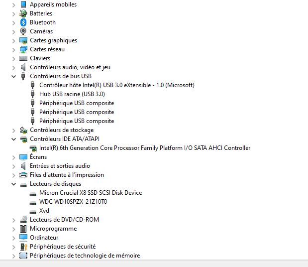

Hopefully one will be able to help me. I bought an external ssd (crucial x8) i have a laptop with a USB C 3.1 Gen 2 and when i check usb controllers in device manager i only have the 3.0 usb host. look at the screen cap please . The x8 promesses up to 1050mb/sec but since windows sees my 3.1 gen 2 type c usb as a 3.0 usb im only getting half the speed .. I d like to get full speed .. any genius in the room pls ive tried many options with no success.. (going in bios , reinstalling this and that, update drivers..) I just cant get the 3.1 controllers driver to load or else plss plsss help Thank you

    2021-04-23T12:10:30+00:00
    good morning John
    Heres two screenshots
    device manager
    and ther other one shows that my external ssd is connected to a usb 3.0 but it is connected to a usb 3.1 windows dont detect it properly.
    Can you try to locate your usb 3.1 host controller drivers/files and send it maybe ??
    Thanks

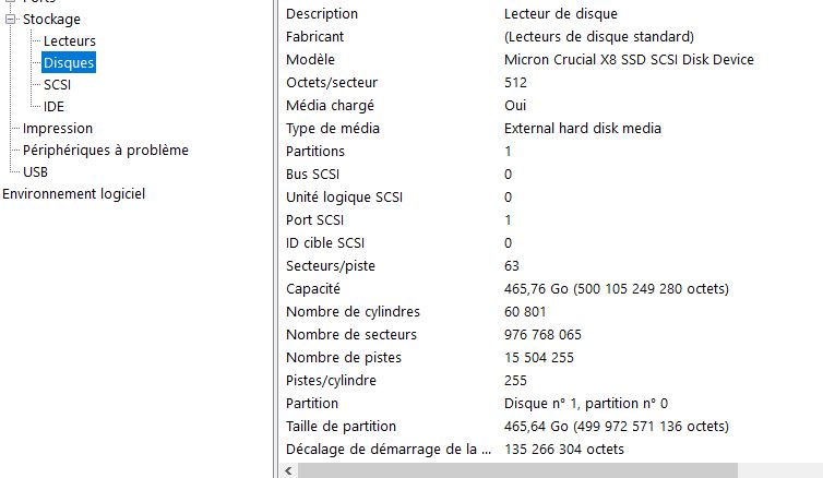

    2021-04-23T12:07:05+00:00
    Louis,
      Are you sure that your external drive is being considered a "fixed drive". What does the standard Windows System Information tool show for your drives. Access it in the Start Menu by "Windows System" > "Windows Administrative Tools" > "System Information". Then go down to "Components" > "Storage" > "Disks". For my external drive it shows as "External hard disk media" while the internal drives show as "Fixed hard disk". There also should be the little external drive icon in the System Tray. If you click on that, see if your external drive shows up there.
