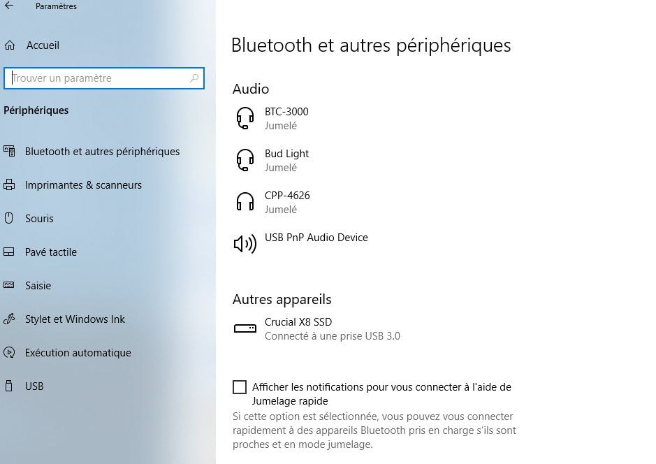

Hello Hello,
Hopefully one will be able to help me. I bought an external ssd (crucial x8) i have a laptop with a USB C 3.1 Gen 2 and when i check usb controllers in device manager i only have the 3.0 usb host. look at the screen cap please . The x8 promesses up to 1050mb/sec but since windows sees my 3.1 gen 2 type c usb as a 3.0 usb im only getting half the speed .. I d like to get full speed .. any genius in the room pls ive tried many options with no success.. (going in bios , reinstalling this and that, update drivers..) I just cant get the 3.1 controllers driver to load or else plss plsss help Thank you

    Hi john ,
    It seems you have the same issue ..
    Notice on the screen cap it says my crucial is connected to a usb 3.0 but it is connected on my usb 3.1 port ...you go there using control panel.
    I suspect yours is detected as usb 3.0 therefore using only 3.0 speeds
    Im also getting a lil less then half the speed i should get (x8 promises a speedy 1050 mb/sec)

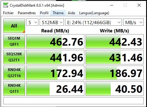

    Im using this free app to check read and write...
    CrystalDiskMark – Crystal Dew World (crystalmark.info)
    CrystalDiskMark8 heres a screen cap of my results
    Check it out and please let me know .. Thanks
