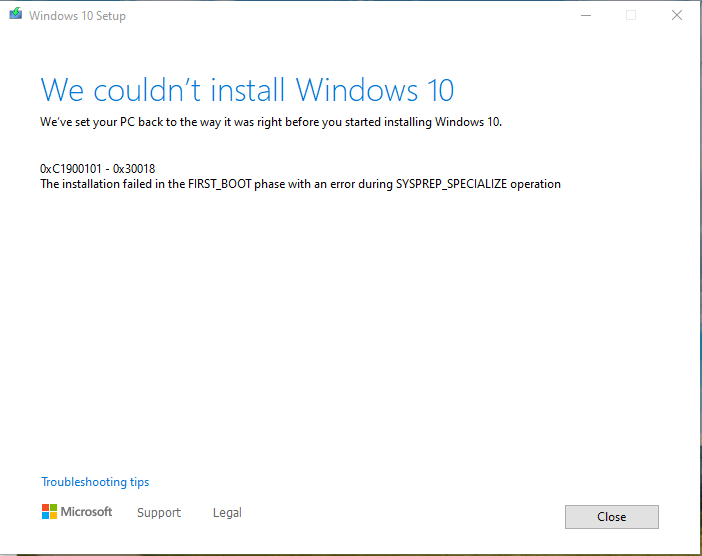

    Before your suggestion came, I tried contacting Microsoft support chat and explained gave them this thread as reference. They suggested I go through the Repair Upgrade process except that this time I download the ISO file to desktop and try do a "Custom installation that will remove all your apps but will not affect personal files". I tried that too but same sequence of events happened and I restored to the same old status.
    However, this time and the last time I tried the Media Installation time, Windows 10 Setup screen with the following message shows up on the first boot.
    "We couldn't install Windows 10.
    We've set your PC back to the way it was right before you started installing Windows 10.
    0xC1900101 - 0x30018
    The installation failed in the FIRST_BOOT phase with an error during SYSPREP_SPECIALIZE operation"
    One thing, I did notice even before I started all this is that the "Update history" page of Settings consistently showed the error 0xC1900101 everytime I tried the major update in the past week.

    I did go ahead, download the 2004 version and tried installing as per your instructions earlier. This time, however I did a clean boot, and installed without the option to download updates (though I should say that the clean boot was probably not complete as msconfig kept freezing everytime I tried to disable non-Microsoft services and would not shutdown properly). Nevertheless the result was the same and I got the following screen.

    The Setuperr log indicates "SYSPRP SPPNP: Unable to install primitive drivers. Err = 0x13[gle=0x00000013]".

    Please try to find these drivers in the Device Manager. Then update the driver if it's available, if not just uninstall and reinstall them.
    I hope this helps. Feel free to ask back any questions and keep me posted.
