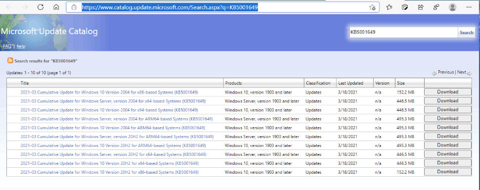

Seems like everyone is facing same issue with this update right now. Try installing ‘KB5001649‘ manually using Update Catalog, see if that works:
https://www.kapilarya.com/manually-download-and-install-windows-updates-in-windows-10
If issue still persists, waiting for a while and then installing it may help, as Sumit suggested.
Let me know if this helps!
Note: Included link in this reply refers to blog post by a trusted Microsoft MVP.

Edit: It worked for me through Windows Update on March 21, but to illustrate use of the Catalog...
(1) At "right-click START, System" mine shows: EditionWin 10 Home, Version20H2, & Architecture of 64-bit.
(2) At "START, Settings, Windows Update, Learn more" which is the Windows 10 update history site, I would click the update that failed (KB5001649)...
https://support.microsoft.com/en-us/topic/march-18-2021-kb5001649-os-builds-19041-870-and-19042-870-out-of-band-ebbe0617-3a63-467a-aaaa-2a4c68a6de33
March 18, 2021—KB5001649 (OS Builds 19041.870 and 19042.870) Out-of-band
(3) Inside that URL, it says to take the SSU (KB4598481) first. Click the link to its description, then click the link to the Microsoft Update Catalog within that one to see...
Mine is near the bottom. It doesn't fully distinguish Edition but Version & Architecture are important.
(3) Then, back in the KB5001649 URL, click its own link to the Microsoft Update Catalog & see...
Again, for me, it is near bottom. You download it, run it, then may delete the raw download.

    I had the same problem, but after reading another post on the same topic suggesting to install the update KB5001649 manually the problem + error code
     was solved. I am from Belgium - Europe. The solution would work worldwide.
    Downloadpage KB5001649
     Here you can take the version that is right for you, on the right side is the download button. then just follow the instructions and you will be asked
    to reboot the PC, may take a while but not long, and the problem is solved. You can check this via your windows update

    This worked for me, too. I clicked on KB5001649 to see what the update consisted of. It gave a link to the catalogue where I could download it manually as a standalone. Once the installer finished downloading, I selected to install it.
    It required a restart, and I also have 19042.870. After my laptop booted back up, I found the download for KB5001649 which was around 449 MB in my downloads folder and deleted it since it was no longer needed. It went to the recycle bin, and I deleted it from there.
    Everything's working fine.
