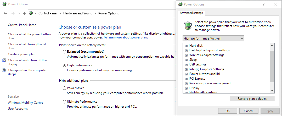

Hi, i have a surface laptop and i cant change my performance in power options in control panel, it would just show balanced for me, and when i press create a new power plan i cant see high performance, it only shows balance, i need a way to get high performance can anyone please help me?

This is a temporary fix i guess, but it works for me nonetheless
using the command:
"powercfg -duplicatescheme 8c5e7fda-e8bf-4a96-9a85-a6e23a8c635c"
does not add the plan high performance in this power plan. So i ended up forcing the plan to run from cmd with this code:
"powercfg -s 8c5e7fda-e8bf-4a96-9a85-a6e23a8c635c"
and create the ".bat" file to have a launcher so i don't have to type whenever i need to use the plan. The plan runs after couple seconds of delay and appear alongside with "balanced plan". If you change the plan to the original one, the high performance one will dissapear so you need to launch the code again.
