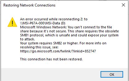

    I have 2 desktop PCs linked via wired Lan to a router that has a USB connected HDD that we use as a poor mans NAS. This has worked perfectly for years until update 2004. Now every time I restart one of the PCs the mapped USB network drive the connection is broken. When clicking on it I get an error box that finished with "the local device name is already in use" If I un-map then remap it works again until the next reboot of the PC. I see a number of others on various forums also reporting this issue with the only solution to be rolling back to the previous version.

    I have a new PC that i installed Windows 10 Pro 2004 on 2 weeks ago. I couldn't initially connect to my Windows XP Pro on that is basically used as a NAS. I enabled NetBIOS over TCP/IP and then I could connect to the XP shares as well to my other Windows 10 machines.
    Now, after a week or so I can no longer get to the XP machine. The XP shared drive shows in File Explorer however when I attempt to open it file explorer hangs with the green bar at the top never reaching the end.
    I cant roll back to 1909 as I have done on my 2 laptops that had the same problem because this machine is new.
    I don't know why it worked for several days and now does not.
    Microsoft really needs to fix this.
