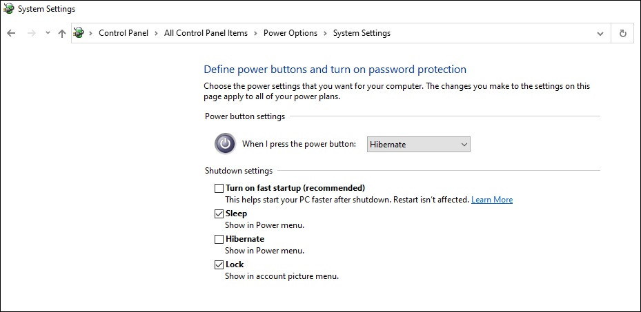

    Two things I found about re-connection to external rives as shares on other platforms. One is the setting that enables rapid restart after a hibernation of shutdown. In Power Options/System Settings DO NOT ENABLE Fast Startup.
