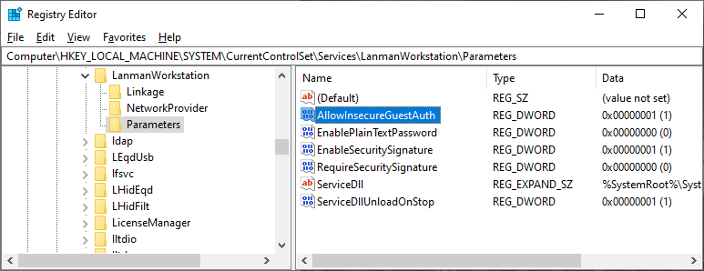

    2020-08-13T13:58:35+00:00
    Changing the following registry entry from 0 to 1 worked for us:
    HKEY_LOCAL_MACHINE\SYSTEM\CurrentControlSet\Services\LanmanWorkstation\Parameters\AllowInsecureGuestAuth
    Yes but that defeats whatever security you had, doesn't it?
    Maybe ok, maybe not, depending on how secure you want your network to be.
    Microsoft really needs to fix this!!!
    2020-08-13T11:57:41+00:00
