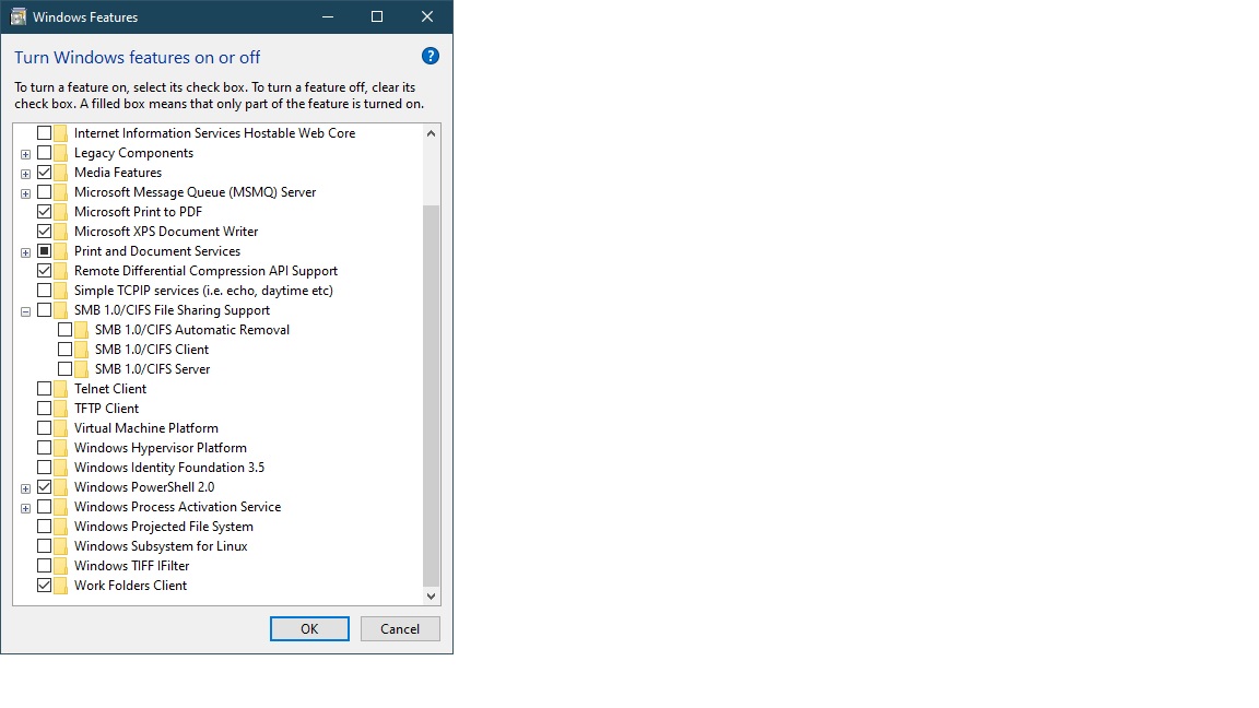

  1. Monkey57 3,535 Reputation points
    2020-11-09T16:15:08+00:00
    "Still can't access after reboot"
    1. in the 'Type here to search' box next to the start menu search for "Windows Features' click 'turn windows features on or off' go down to 'SMB 1.0/CIFS...' click the plus in front, uncheck any checked box in front of the 3 sub item
    reboot when prompted.
    1. go back into 'Windows Features' and put a check in front of 'SMB 1.0/CIFS Client' (only)
    1. after reboot remove(disconnect) all mappings see:
    https://support.microsoft.com/en-us/help/890413/you-may-receive-the-the-local-device-name-is-already-in-use-error-mess
    "To resolve this issue, remove the existing network mapping. Then create a new network mapping for the share."
    That article is regarding connecting to shares on xp or before computers.
    1. Remap your shares.
    2. Reboot-test, Reboot-test  (it stayed working for me on various systems)
    NO registry editing or other settings where changed.
