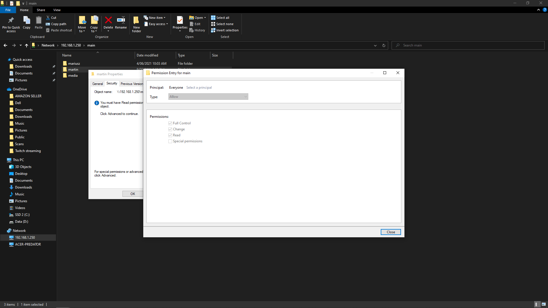

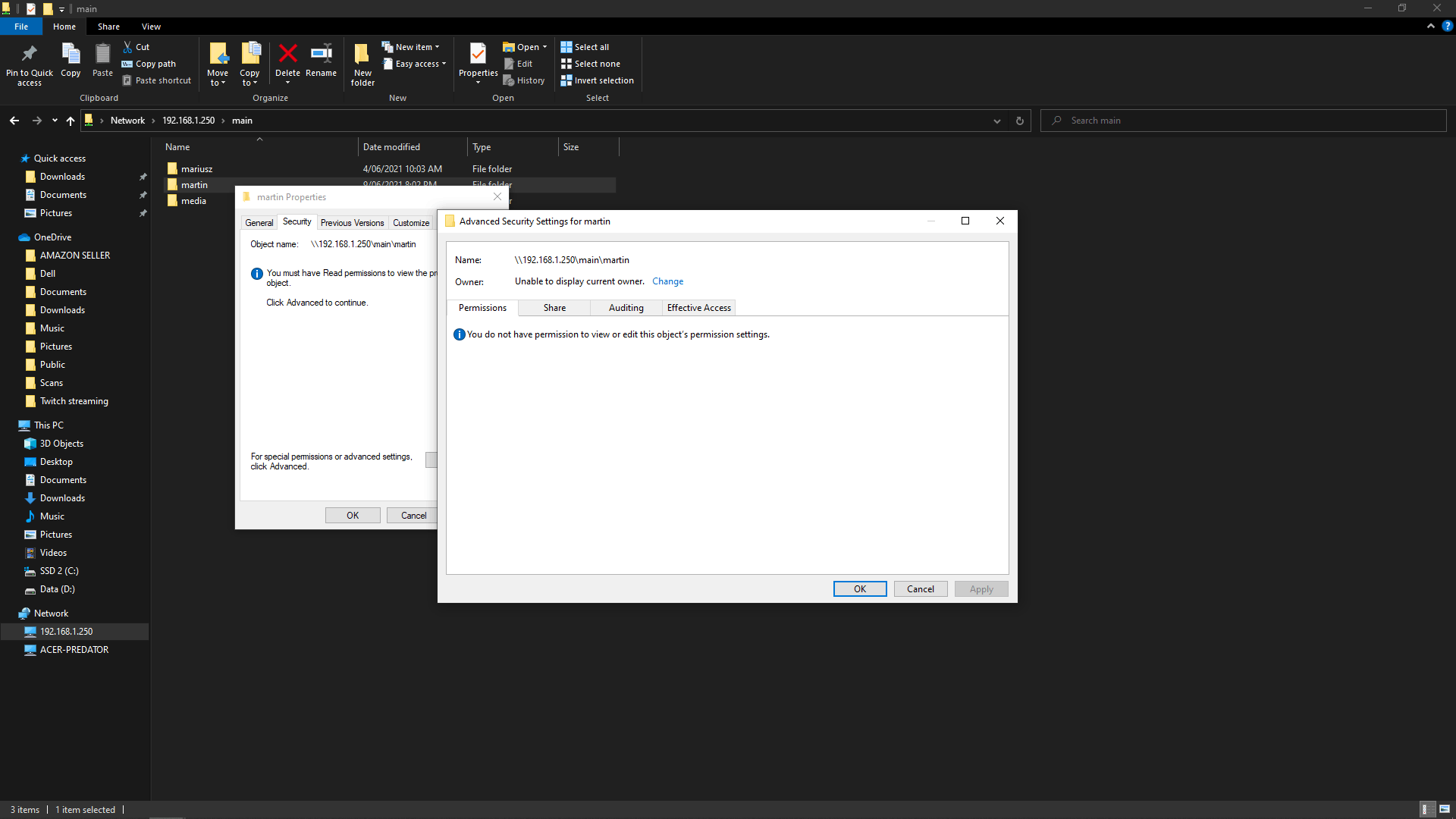

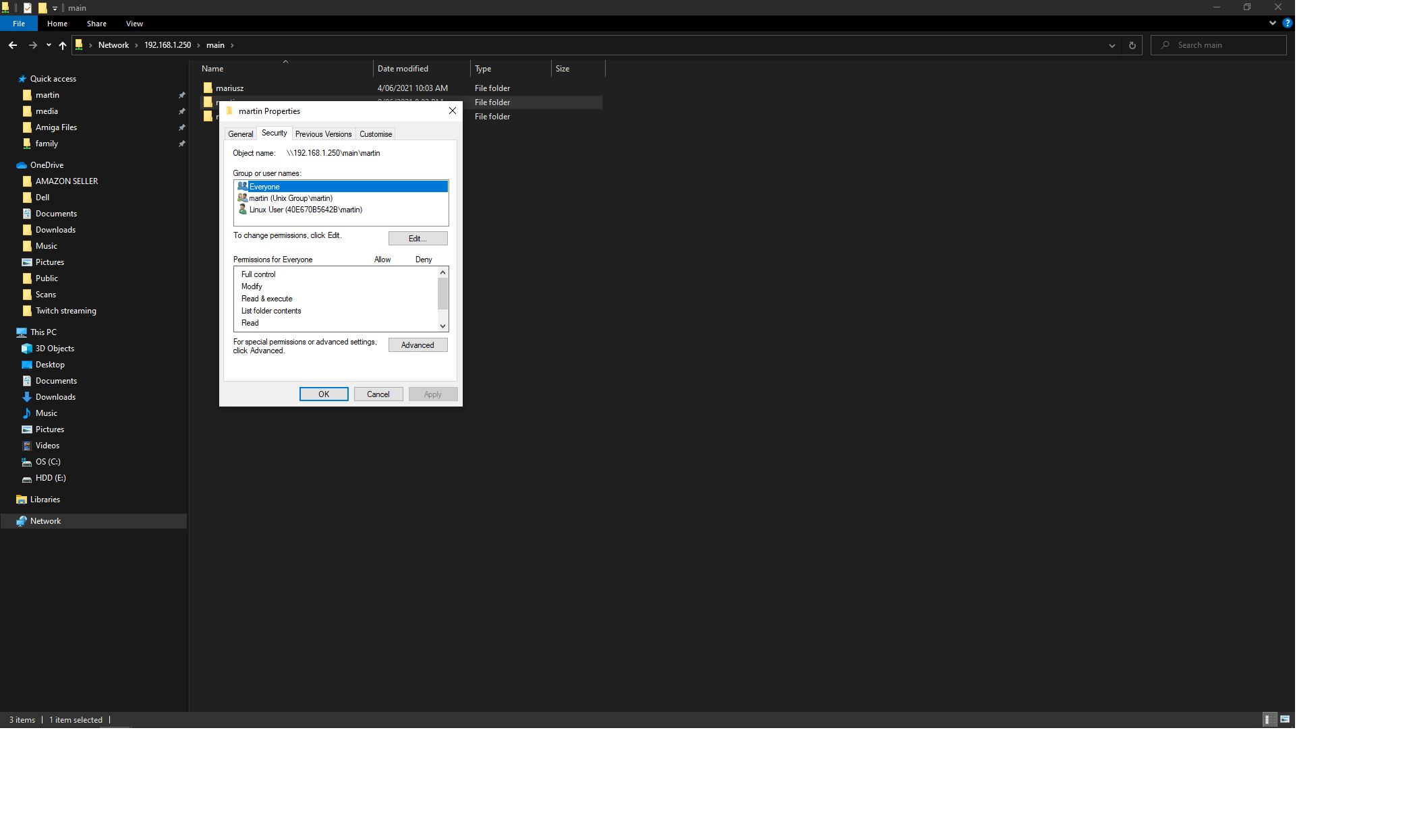

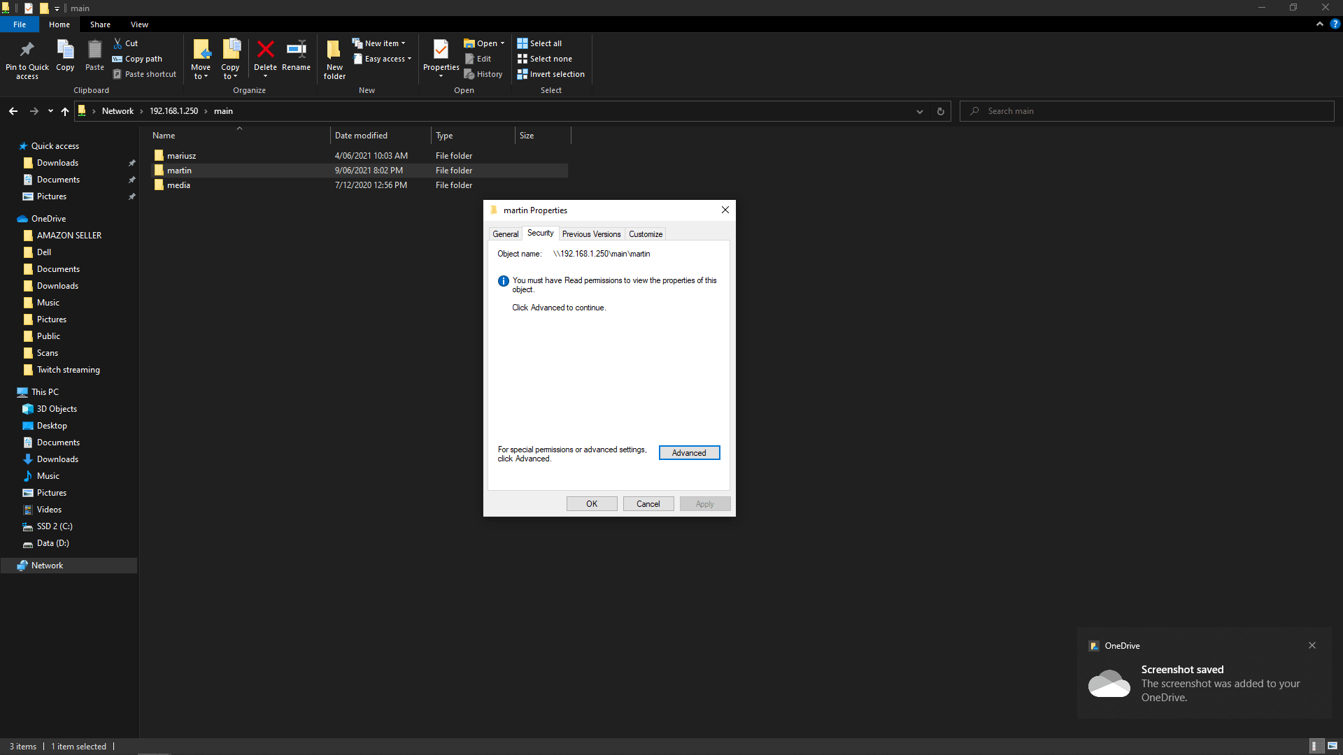

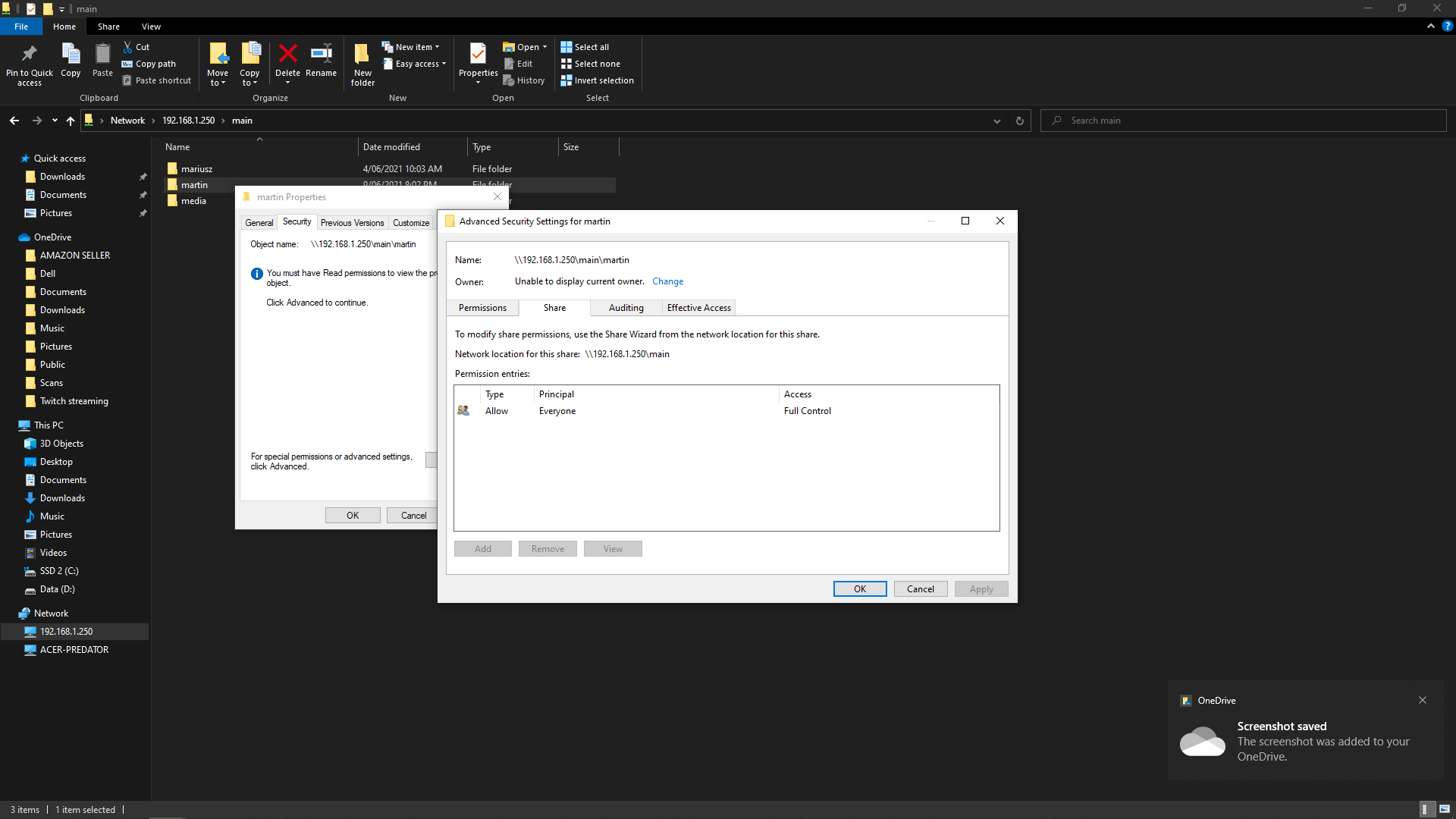

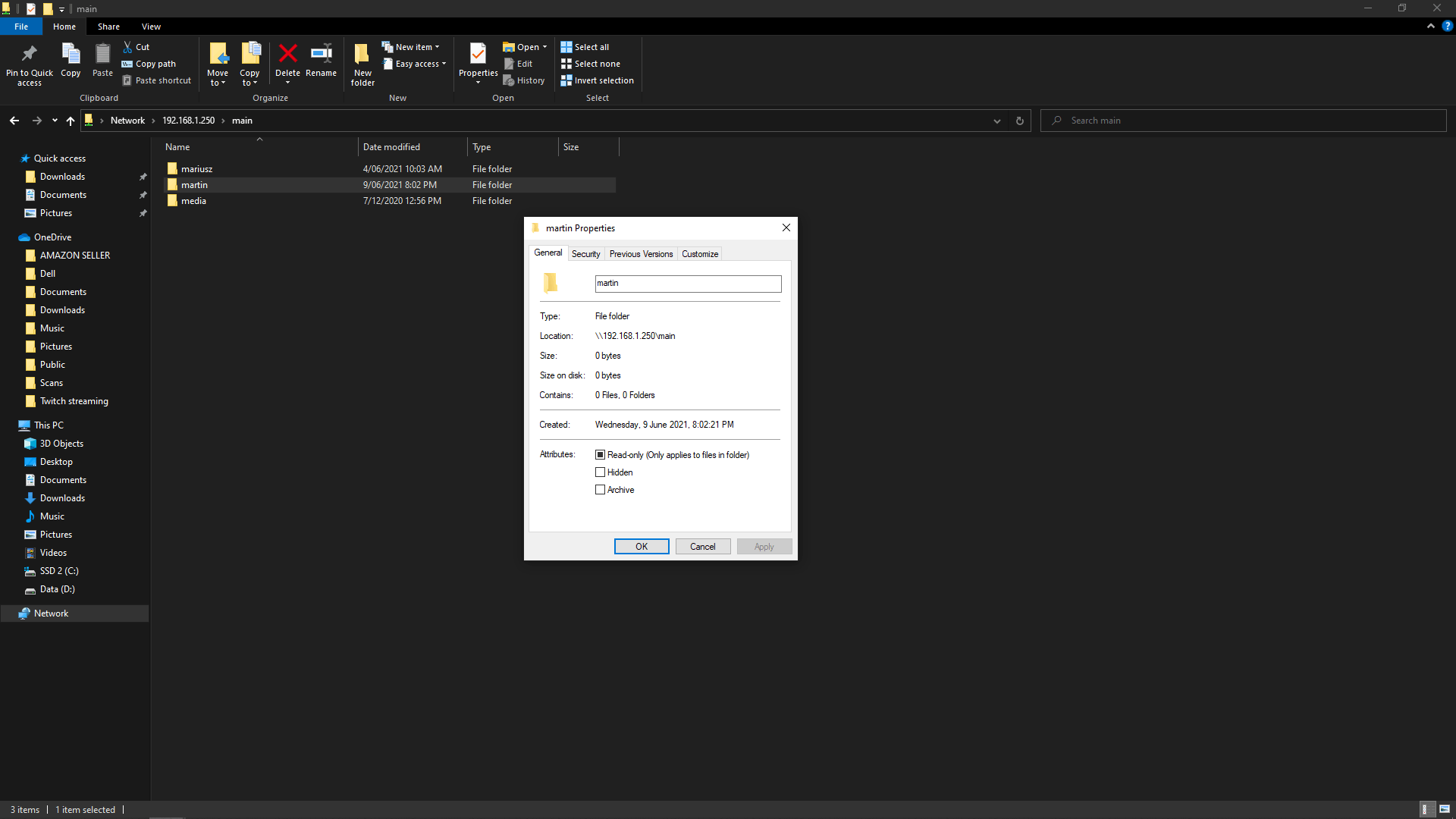

    I have similar problem after updating to windows 20H2 I Can't access shared folders from File Explorer in Windows 10 on one computer ! On others my machines (also after upgrading to latest windows 20H2) everything is fine.
    I tried everything from: https://docs.microsoft.com/en-us/troubleshoot/windows-client/networking/cannot-access-shared-folder-file-explorer.
    No luck at all, very annoying All above on Acer Predator Helios 500 where this is not working.
    Below from Dell laptop where it is fine:
