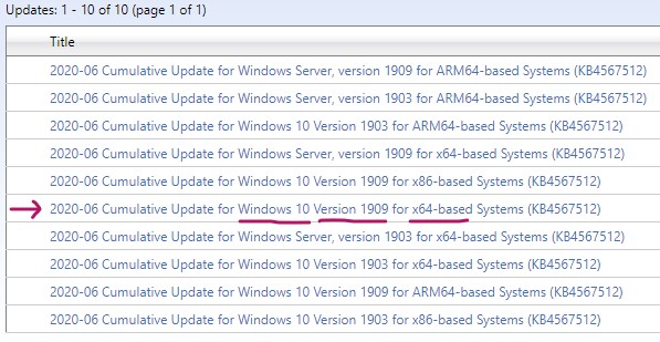

    Odds bodkins, you are right, JohnD...
    https://support.microsoft.com/en-us/help/4567512
    June 16, 2020—KB4567512 (OS Builds 18362.904 and 18363.904)
    It says it's unavailable at Windows Update, but is available here...
    https://www.catalog.update.microsoft.com/Search.aspx?q=KB4567512
    Microsoft Update Catalog -- KB4567512
    Take the one that matches what is seen at "Right-click START, System" regarding Edition, Version & Architecture. For me, it would be Windows 10 Home, version 1909, & 64-bit...

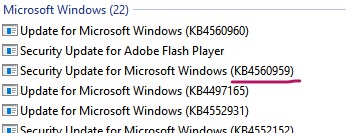

    It would be like that for the SSU (KB4560959) too, but I think everyone already has that at "START, Settings, Update & Security, View Update History, Uninstall updates"...

    Try taking KB4567512 from the Microsoft Update Catalog. The two you mention are not known to cause the problem. I've got both installed & can print.

    You are welcome. May as well try KB4567512 from the Catalog. I think uninstalling more than KB4560960 is overkill.

    I had the same problem. I got my printer to work by uninstalling the "Update for Microsoft Windows (KB4560959)"  6/13/2020.
