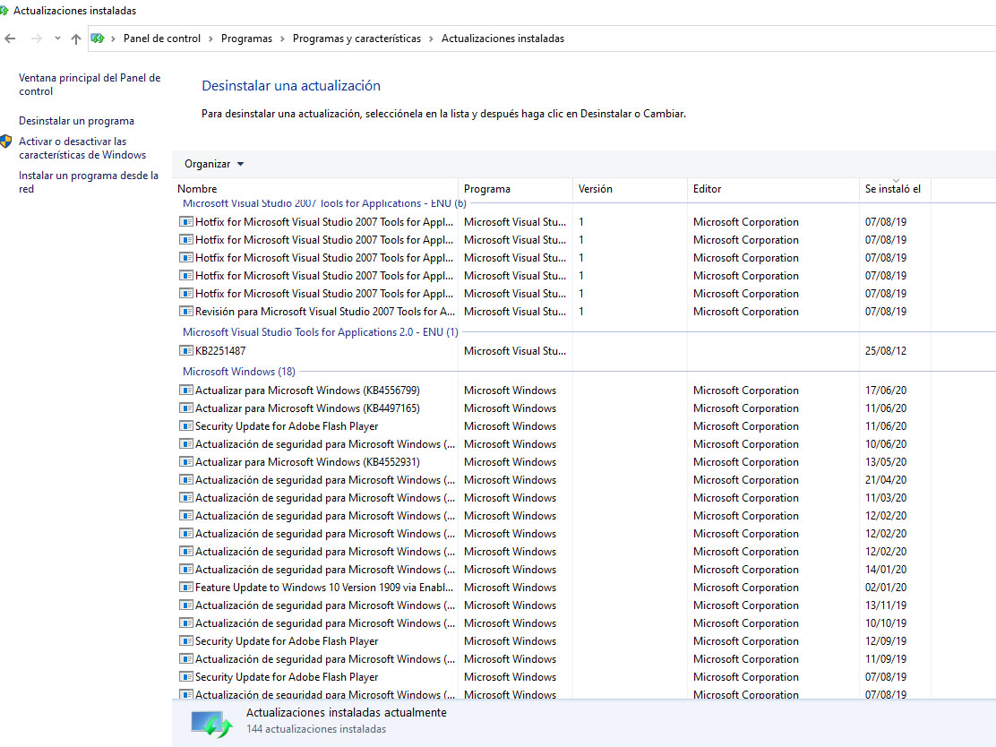

try uninstalling the adboe security update and restart and it shud work, let me know.
thankyou pcr, jst uninstalled kb...60960 and kb ..557957.. and also a adobe security updte. and it printer started working. thankyou so much.
