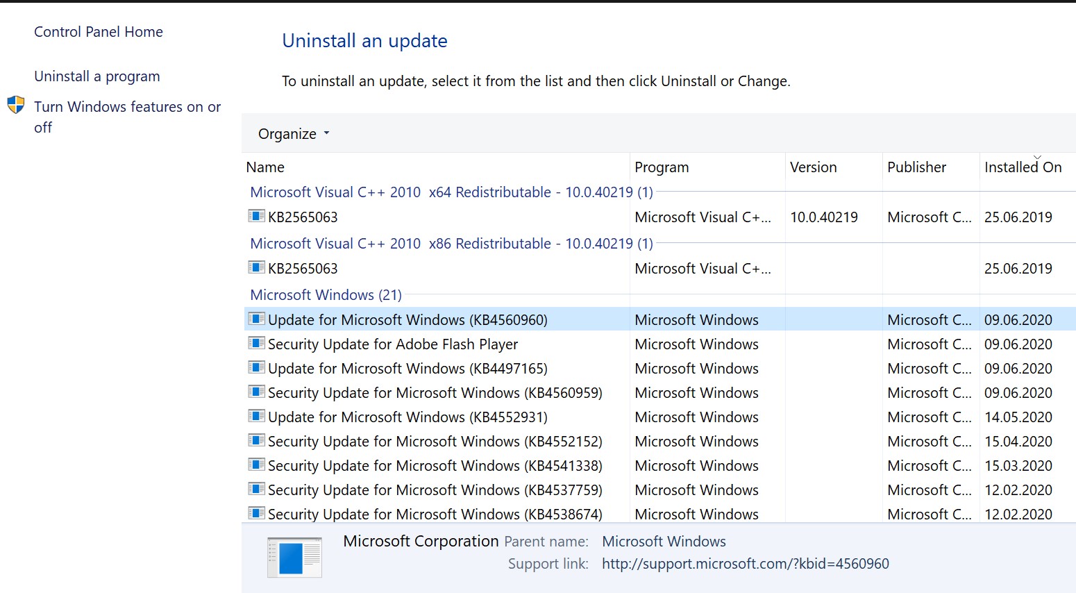

    How did you unistalled the update? From control panel if i selected the KB4560960 it doesn't show Unistall botton. Which metod did you use for unistall this update? Thanks you.

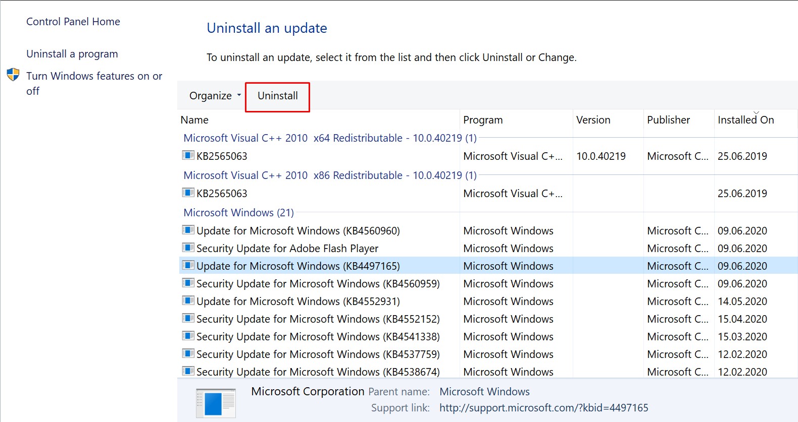

    I used "wusa /uninstall /KB:4560960" and its worked on 5 computers. Make sure to use an admin command shell. However on 1 computer the update seems to be marked as non-removeable so I haven’t been able to uninstall the update on that, its not clear why. (I havent been able to try in safe mode/recovery mode yet)

    From the control panel.  Highlight KB4560960.  Highlighted it.  I believe there was an "Uninstall" button that appeared, or else there is an "Uninstall" at the top of the page.  Good Luck.  This is a Microsoft pain.

    I have another problem....i just can't uninstall this KB4560960 :( i'm getting the message bellow
    i'v alreaddy run the "wushowhide.diagcab" but still no results
    is it another way to forece uninstal this KB ? ...i really nead my printer dear Windows 10 :(

    The "Uninstall" only apers for the KB that the sistem "thinks" it's safe to uninstal....otherwise it dose not appear
