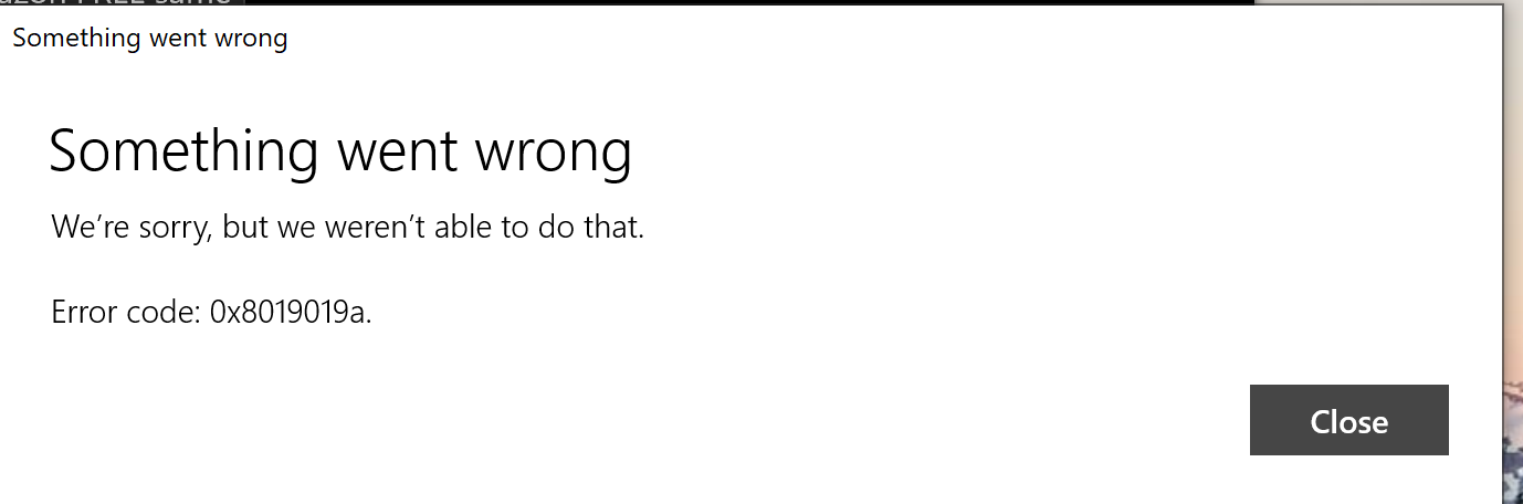

I upgraded a Toshiba Satellite C55-B laptop from Windows 8 to Windows Home 10.0.19041.
I've successfully set up Outlook and Gmail email accounts, but when I try to set up my Yahoo account, I get an error code: 0x8019019a.
My Yahoo account indicates that my mail and calendar were signed into, but the actual setup in either Outlook or the Windows Mail app has failed.
Any thoughts on what I can do to correct this?

    2020-08-08T11:27:05+00:00
    I also have been getting this error since changing my Yahoo password.  Something must be up.
    I can log into the Yahoo web mail log in no problem, but putting in the exact password into the Windows Mail app produces this error
    I click the Fix account notification, then enter the email address and exact password. All looks hopeful, then get the Something went wrong message.  Intriguingly, I get an email sent to my gmail account (my back up Yahoo address) stating that xxx yahoo  account was just used to sign into Mail .  You're all set.
    So, it seems that something is broken in the messaging somewhere or maybe a time lag.
    Last time this happened, I gave up, then a few hours later, the Yahoo emails started arriving via the Mail app without me doing anything.
    2020-08-08T22:00:49+00:00
    Error code 0x8019019a is what i get when i try to update my mail.
