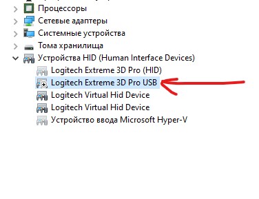

So I went to the Device manager and checked all my devices if they affect the sleep mode. (be careful, do not de-activate mouse AND keyboard ;) )
I concentrated on the game controller as they seem to be the troublemaker in 99% of the cases (as in mine...)
Disabling both devices (throttle and stick) makes PC sleep normally.
Both devices do not have a power management tab and i could not change power settings or wake setting using the command line.
What is strange in my case:
If I do a clean re-start of my system sleep mode of the monitor won't work.If I then just shortly de-activate and re-activate both the throttle and the stick in the device manager sleep mode will work like a charm again.
So I do not have to keep my devices plugged out, I just need to have them shortly disabled once.

pnputil /disable-device "HID\VID_044F&PID_B10A\6&1D8AD952&0&0000"
pnputil /disable-device "HID\VID_044F&PID_B687\7&2808F29F&0&0000"
sleep 1
pnputil /enable-device "HID\VID_044F&PID_B10A\6&1D8AD952&0&0000"
pnputil /enable-device "HID\VID_044F&PID_B687\7&2808F29F&0&0000"
In the " " brackets is the ID for my HID-compliant game controllers. This can be found in the device manager.
Right click on the device --> Properties --> Details --> Device Instance Path (or similar, translated by me from German "Geräteinstanzpfad")
If you have mor or less devices causing this problem, then change the code accordingly.
