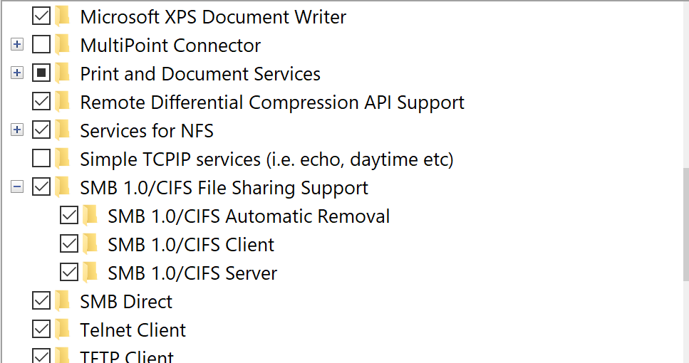

    I attempted to remove smb1 via Programs & Features, reboot, then re-add.  I was able to re-add it but it still didn't work.
    Then I used Powershell commands I found on link below.  It worked for me on 2 of my workstations.
    https://docs.microsoft.com/en-us/windows-server/storage/file-server/troubleshoot/detect-enable-and-disable-smbv1-v2-v3
    Perhaps the "on-line" featureset is newer than the local feature set.
    Here are the commands.  Run Powershell as administrator.
    Get-WindowsOptionalFeature -Online -FeatureName smb1protocol
    Disable-WindowsOptionalFeature -Online -FeatureName smb1protocol
    Enable-WindowsOptionalFeature -Online -FeatureName smb1protocol
