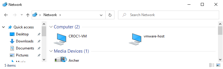

    2020-07-31T19:30:54+00:00
    I forgot to mention in my post that I tried all the suggestions in previous posts. If you look in the picture below my share "Archer" is not listed.

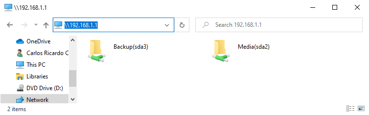

    But now I just tried to access typing the IP on the address bar and bam... the folder in my share appeared.
