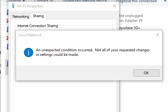

    2020-08-04T07:19:07+00:00
    My Window 10 pc's sharing option was working fine.
    I share my pc's vpn to my console.
    But after windows update, when i try to share it says unexpected condition occured. not all of your request in the settings could be made. So I installed thirdparty app and it doesn't work until we purchase pro membership.
