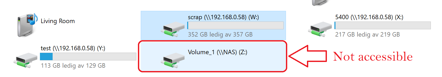

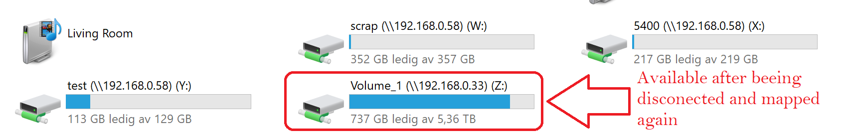

    The old NAS is a D-Link DNS-345, which I bought in January 2012.
    The new NAS is a Synology DS1821+.
    I'll se how long the Synology will stay connected...
    The SMB might be a way to the answer, as I had tick off SMB1, on my sons computer in order for it to connect to the old NAS, after it had been shut down for a longer period of time. I have not tried to connect to the new NAS on that computer yet, and I have not found anything concretete in regards to the SMB.
