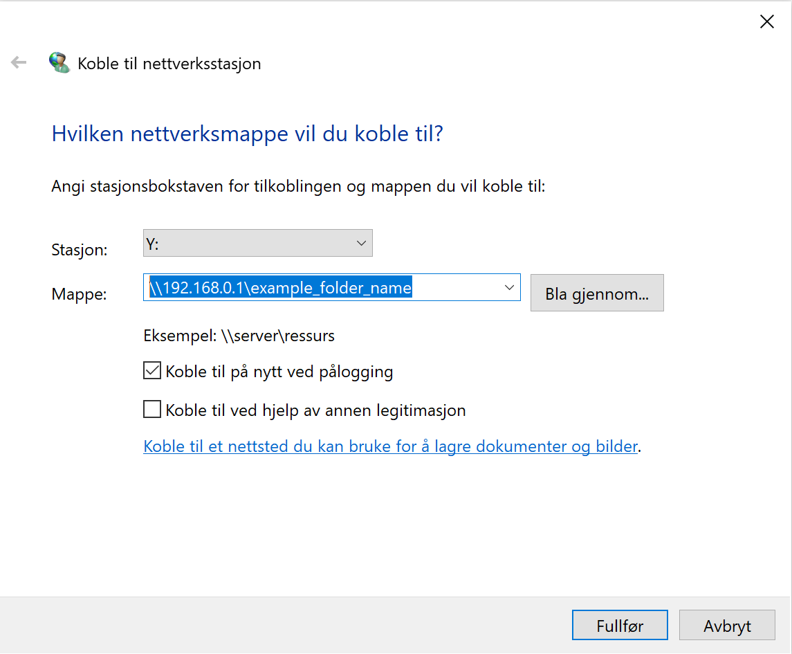

If I map the drive by the name (\MyBookWorld\Public) the map works OK until I reboot.  After reboot, I get the error of "The Specified network name is no longer available".  I cannot connect to drive via start>>run either.  If I try to access the drive by IP address using start>>run, it works.
If I disconnect the map drive and reboot, I can connect from start run to the drive after every reboot.
If I map the drive by IP address, reboot and then try to use the drive, I get "Microsoft Windows Network:  The local device name is already in use".  Net use shows the drive disconnected and has an entry to the unc name.  It works if I use start>>run to the UNC name.
