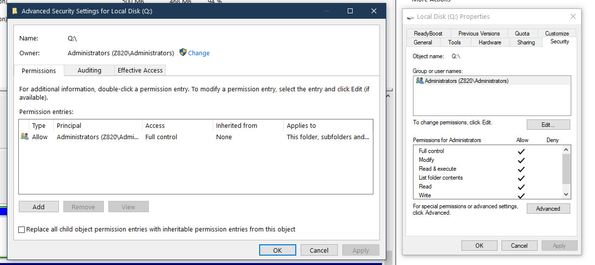

    Did it allow you to change Ownership and add a User, or did that get the access denied error as well ?
    One thing you should do... Turn off Fast Startup.. If it is turned on when the computer is shutdown and then drives are removed, it can cause issues with the drives very similar to a power outage or disconnecting them when they are running.. There is a chance that this is what actually caused the problem, but I think it may still be related to Permissions..
    If you are using a Microsoft Account, try switching to a Local Account, then do the Owner\User change again.. Microsoft Accounts are more restrictive than Local Accounts..

    Changing permissions doesn't seem to be an issue. Adding users and such isn't either. I even downloaded the registry entry to add the "Take Ownership" to the context menu. All it did was flicker the screen and maintain the ownership I already have. Perhaps there is a combo that I haven't attempted yet that might work, but I honestly don't feel like it may work.

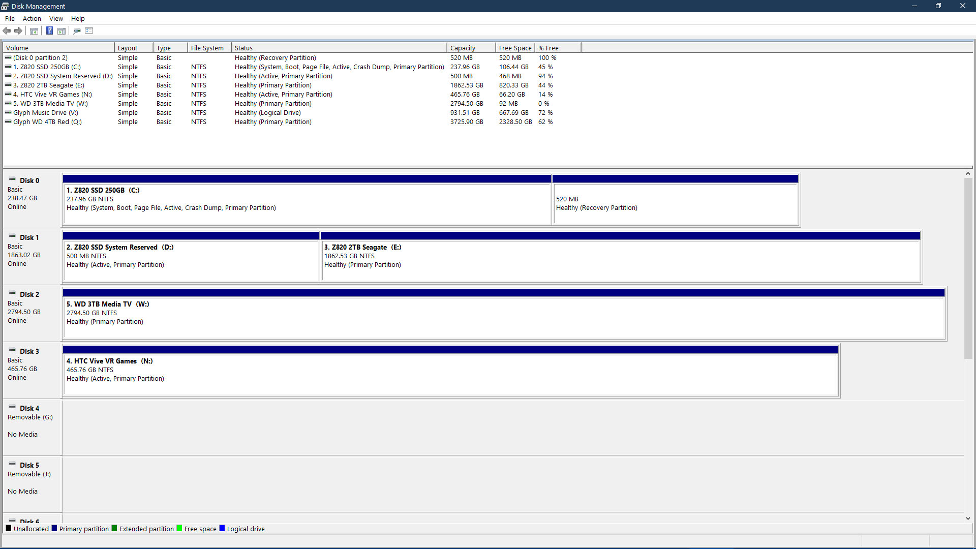

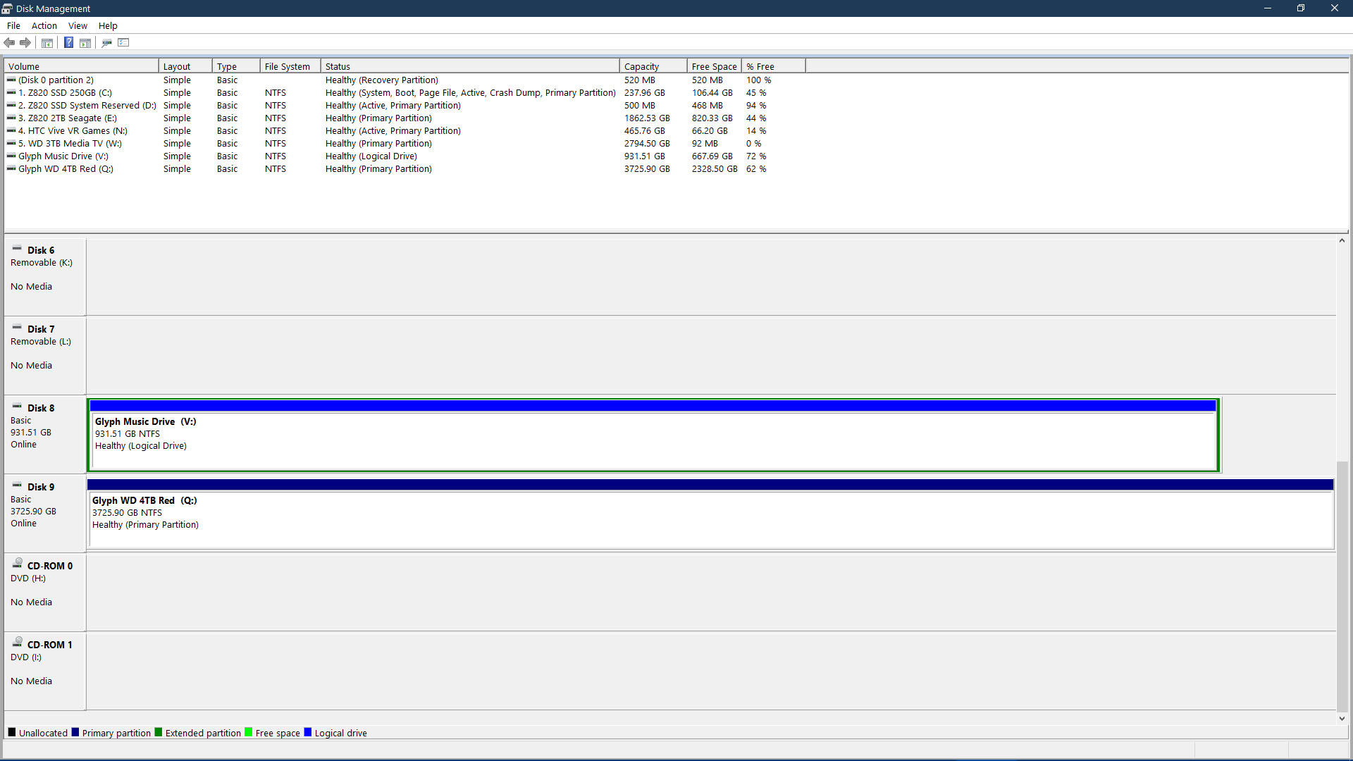

    Forgot to add the screenshots:

    Part of the problem may be that the Owner is "Administrators".. That probably will not work for various reasons to long to type..
    You should make your account the owner, which would be the User name of your C:\USER folder...
    Then add your account as a User with full permission..
    Some people have had better luck setting the Owner as "Everyone" and adding "Everyone" as a Use with Full Permissions... This can be helpful when switching external drives between different machines..
    Edit... Is there any particular reason one of your drives was created as a "Logical" drive ?

    I already tried adding me/user to it only with no success. Along with adding both admin and user, everyone, system, everything - you name it, I most likely tried it - resetting everything, and so much more. Absolutely nothing worked when it came to fussing with the permissions.
    As far as the drive being logical, I never did that. It was a physical drive since day one when I took it out of the box. All this hell happened when I turned on my drive after booting up my PC on day 3 of win10 breaking down.
