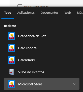

    Me too, I have the problem with the Windows 10 calculator. I have also tried other apps such as calendar, voice recorder, WhatsApp and it happens the same as with the calculator.
    Apps do not have their default icons
