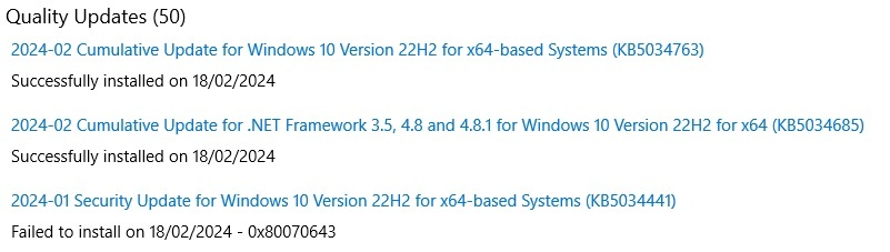

    Just one last update from my side. I paused all updates for nearly a month to allow Microsoft to address the issues and updated 2 days ago.
    The one 'quality update' that failed was KB 5034441. If this appears in your list, I would leave it out as it must have been overridden by a subsequent update KB#
    Image of relevant updates below.
    Hope that helps.
