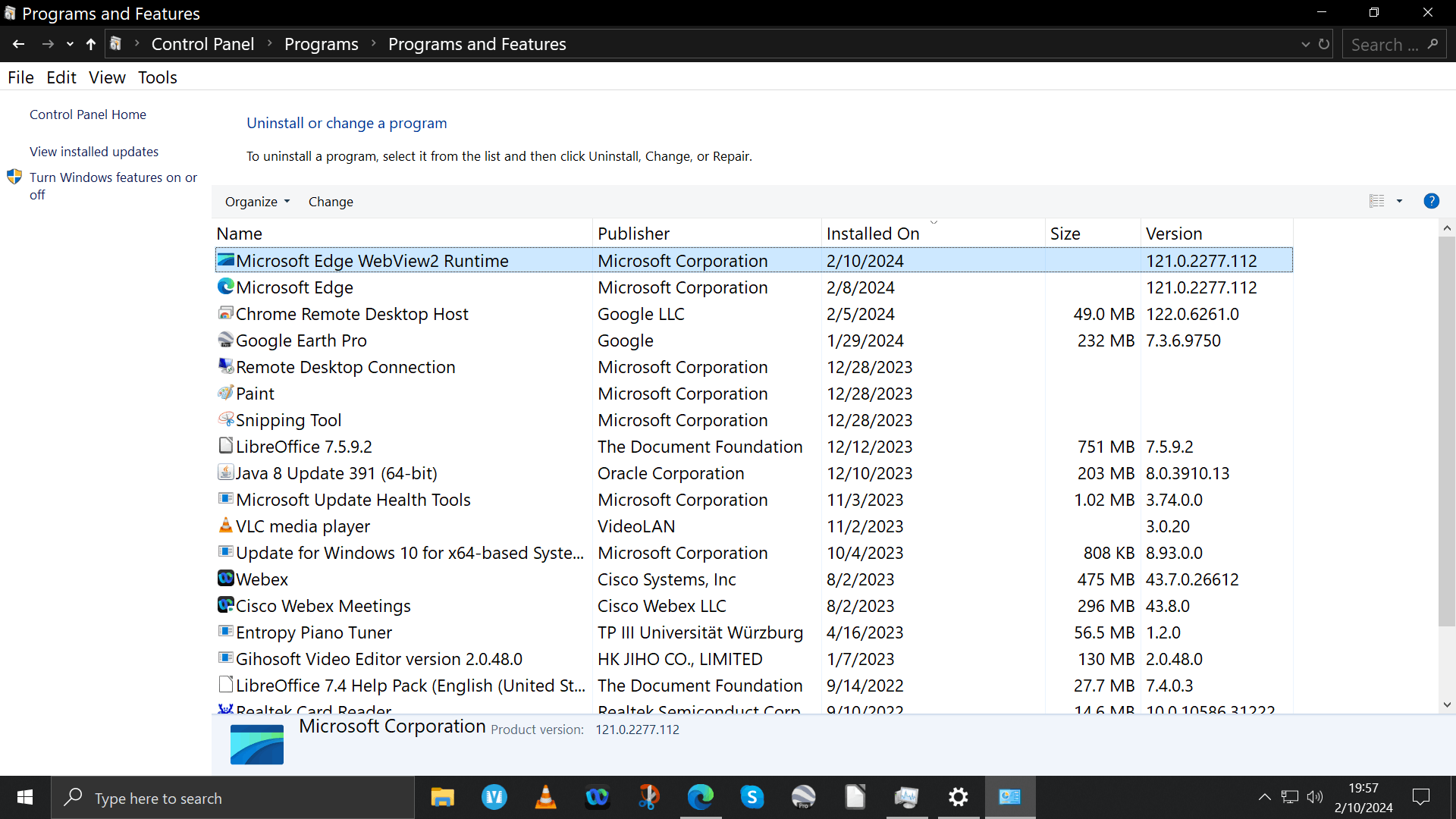

    J Mag: (people always call me 'Rosco' but I'm really Ross.
    I've been communicating with them. They've updated my Edge on the 5th, 8th. Today the 10th. I received an Update: "Microsoft Edge WebView2 Runtime." SEE attached installed programs list. I have my Windows Update Settings on 'pause' until after the 13th, but I do have the box "update as soon as they are available" CHECKED. (as I wondered how they kept updating without my knowing). Today, except for the "High Memory Usage Warnings" (of which I told them today) things are working much better. (29) Edge processes while Open, and files are being correctly deleted or saved according to my settings. And, when closed, there were still 12 Edge processes with (0) zero movement (probably not running). Seemed OK to me.
