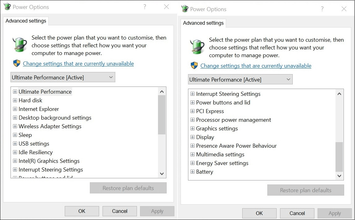

The CsEnabled not available anymore for windows 10 v2004 but you can still restore all the power plans and power settings: DOWNLOAD
There is no need to use a command prompt or registry editor and all you need to do is just click on the batch file then it is fixed.
POWER SCHEMES FOLDER:
Power Saver & High Performance ~ To import the original windows power plans.
Ultimate Performance ~ This power plan is only to be used on higher-end PCs.
Restore Profile ~ To clear and reset the original Windows Power Profile.
POWER SETTINGS FOLDER:
Default Enable ~ To automatically restore all windows standard power settings.
Advanced Enable ~ To automatically restore all windows expert power settings.
Settings Disable ~ To automatically remove all the windows power settings.
Troubleshooter ~ To fix problems with power settings and conserve battery life.
DEFAULT & ADVANCED OPTIONS:
To manually enable or disable your own power settings by clicking on the reg files.
DIAGNOSE TOOLS:
A collection of diagnostic windows system power tools for fault-finding the issues.

    2020-10-19T00:01:24+00:00
    Version 2004 does not appear to allow the use of S3, nor provides the ability to disable S0 (Connected Standby)
    2020-10-21T10:59:40+00:00
    I am hoping you can help me.
    When I follow the steps above to edit the Registry Editor, there is no "CSenabled button available".
    It is simply no-where to be found for me.
    I have included a screenshot below.
    Do you know what I should do in this case?
    I look forward to your reply.
    Thanks
    2020-10-21T12:18:24+00:00
    Microsoft thought it would be a brilliant idea to remove the CsEnabled registry key from version 2004, so they did.
    Never mind how may loyal users want to be able to disable Modern Standby (because it's rubbish). Microsoft knows best. Apparently.
    Your only option is to roll back to the previous version.
