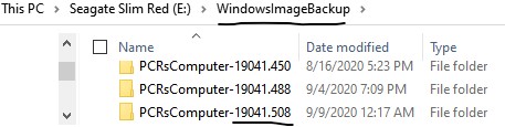

    I rename the computername folder which is inside the WindowsImageBackup folder (by adding the OS Build to it) in order to keep them separate & distinct. All three will be offered during the restore process.
