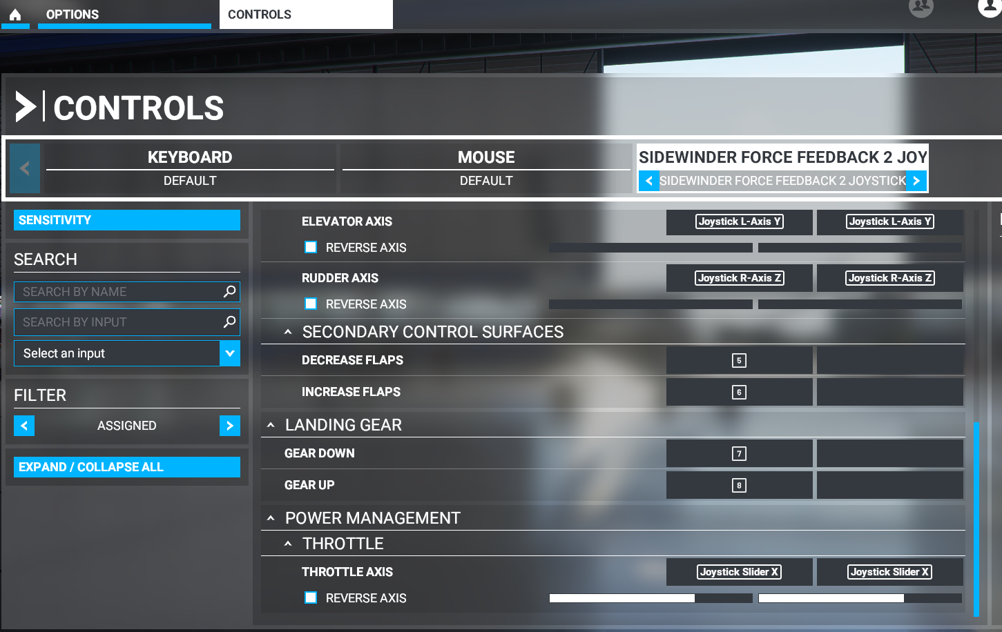

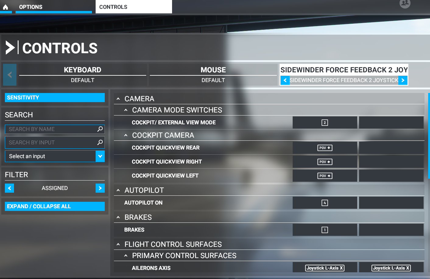

    I got my MS Sidewinder Force Feedback 2 working with Flight Simulator 2020 tonight. To set it up I did the following:
    In Flight Simulator 2020, Under 'Options' - 'Controls' select the tab that has the Sidewinder.  Then on 'Filter' select 'All' (not 'Assigned').  Then you have to set up each button, slider, stick movement etc.  Here are the mappings I used for mine which works pretty good as far as basic flight (throttle, ailerons, rudder, throttle, etc.).  I included some others I setup too, but the flight controls are essential.  Also, I will try to attach a couple of screen shots to make it easier to follow:
    Flight Control Surfaces - Primary Control Surfaces
       - Ailerons Axis is set to: 'Joystick L-Axis X' in both slots (left and right)
       - Elevator Axis is set to: 'Joystick L-Axis Y' in both slots (left and right)
       - Rudder Axis is set to: 'Joystick R-Axis Z' in both slots (left and right)
    Power Management - Throttle
       - Throttle Axis is set to: 'Joystick Slider X' in both slots (left and right)
    The rest are just how I have mine setup and are pretty straight forward.  However, you may choose different mappings of course:
    Camera - Camera Mode Switches
       - Cockpit/External View Mode set to: '2'
    Camera - Cockpit Camera
       - Cockpit Quickview Rear set to: 'POV down-arrow'
       - Cockpit Quickview Right set to: 'POV right-arrow'
       - Cockpit Quickview Left set to: 'POV left-arrow'
    Brakes
       -Brakes set to '1'
    Autopilot
       - Autopilot On set to: '4'
    Flight Control Surfaces - Secondary Control Surfaces
       - Decrease Flaps set to: '5'
       - Increase Flaps set to: '6'
    Landing Gear
       - Gear Down set to: '7'
       - Gear Up set to: '8'
    Hopefully this helps someone with their trusty Sidewinder.
