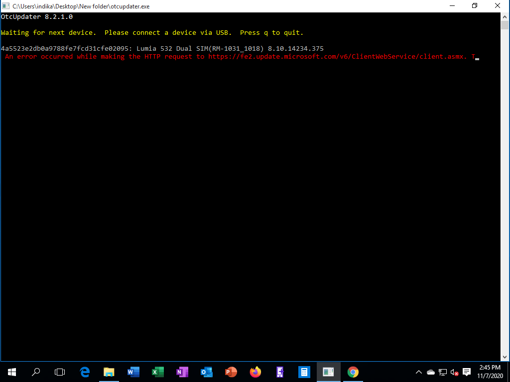

when i try to update the windows 10 for Lumia 532  using  OtcUpdater 8.2.1.0 after few minutes getting the error as follows " An error occurred while making the HTTP request to https://fe2.update.microsoft.com/v6/ClientWebService/client.asmx. T "
please help me to recertify the my problem

    Try the solution given in this post:
    https://answers.microsoft.com/en-us/mobiledevices/forum/all/otc-tool-server-issues-fix-here/03cc2165-71b5-4fd6-8e64-5065d2000838
    Solution in the post doesn't work (isn't it incomplete or something?). OTC Updater still can't establish a secure connection.
    There was a second post in that thread with more detailed instructions which the author has decided to delete, I have no idea why. This is now posted as a new thread:
    https://answers.microsoft.com/en-us/mobiledevices/forum/all/otc-updater/b2fb7107-7e1f-4d30-b441-7313524ceed4
    Try also this MS resource, the relevant information is at the bottom of the page:
    https://docs.microsoft.com/en-us/mem/configmgr/core/plan-design/security/enable-tls-1-2-client
    In short, MS have updated the properties of the servers which the OTC updater tool is programmed to look for, however they have not updated the OTC itself since W10M reached end of support in January this year and is no longer maintained. The only way to get it to work is by using the suggested workaround involving the registry edit.

    hi
    I`m still getting update issues for following error form the otc update
    please help me to solve this issues
    thank
