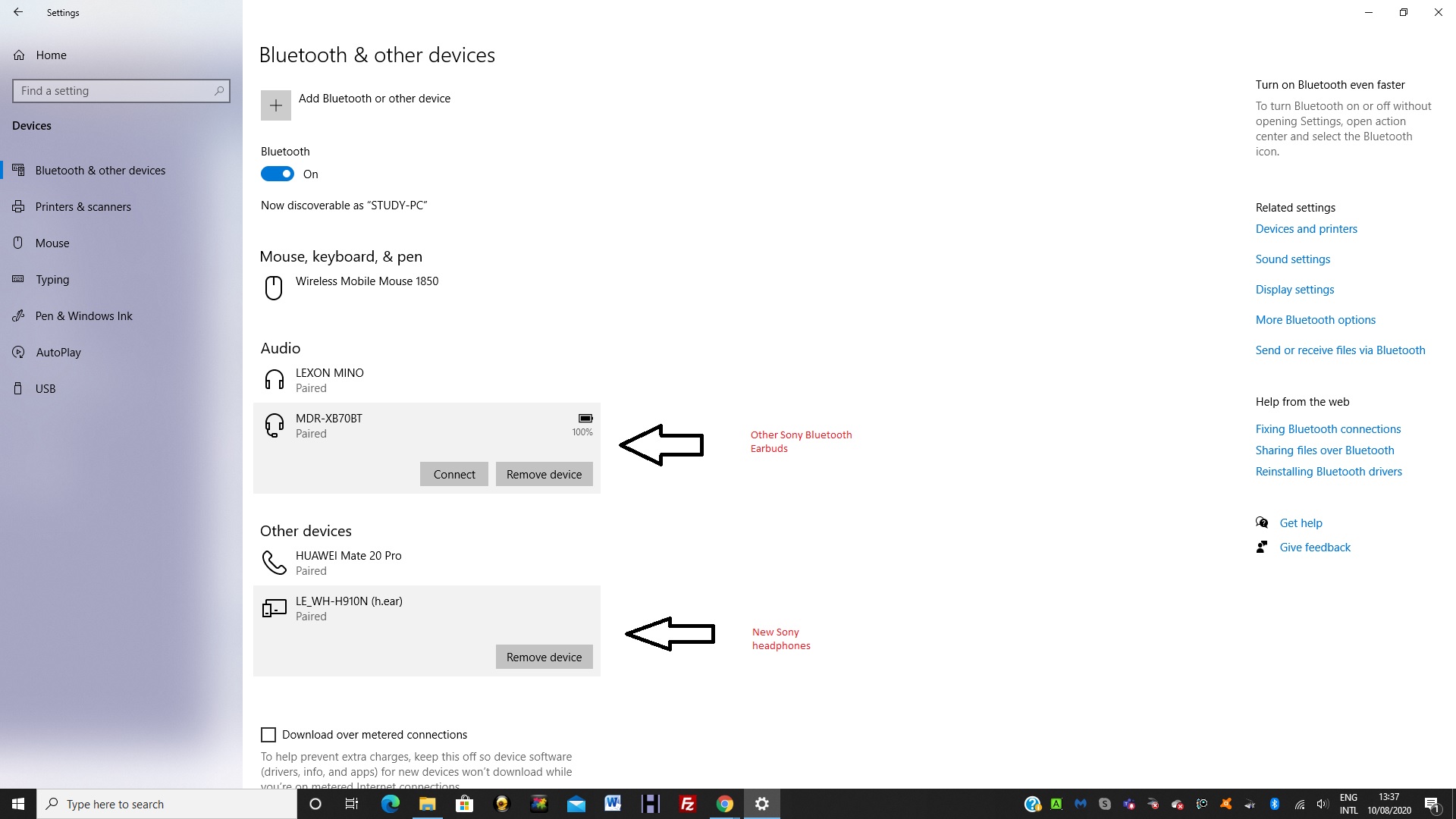

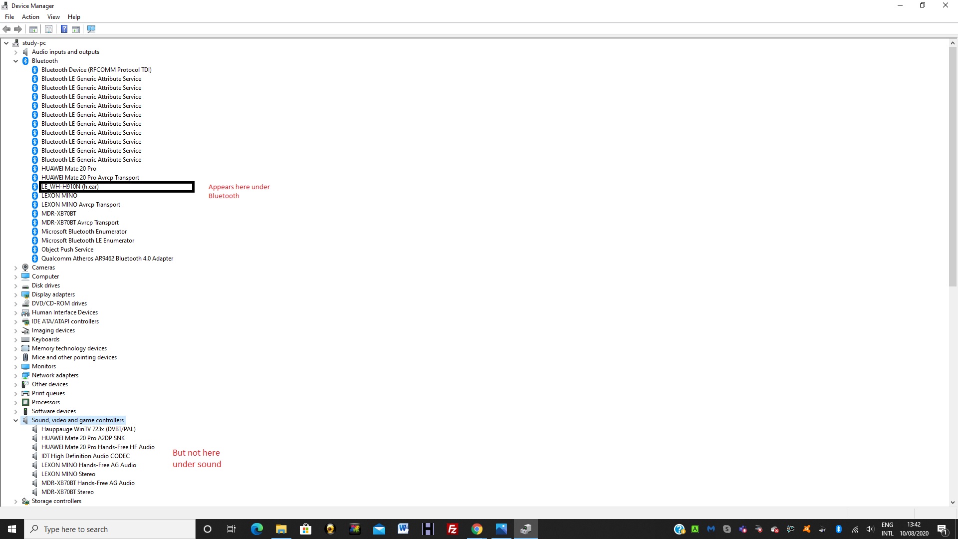

I would like to connect them to my HP PC running Windows 10. I can pair the headphones, but they are not recognised as an Audio Device. My MDR-XB70BT ear buds are recognised as an Audio device, but not my WH-H910N h.ear.Headphones.
When I pair my WH-H910N h.ear - they are paired under 'Óther Devices' - which is where my phone sits as well. Because they sit here there is no option "connect" to them, only the option to 'remove device'
Can anyone explain why the headphones would not be recognised as Audio?

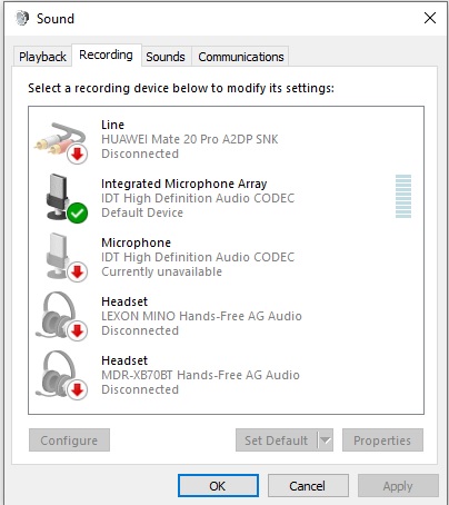

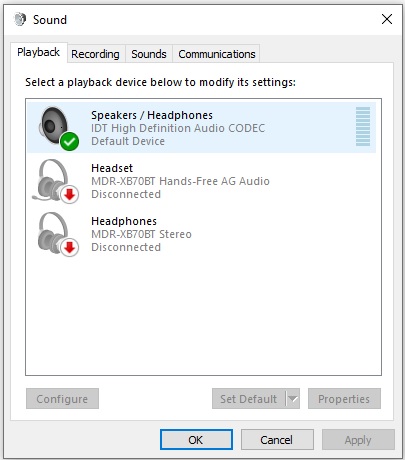

You will see that my Sony Bluetooth earbuds appear in both playback & recording, but my new headphones do not.

    I am not having problems pairing the headphone, it pairs. My problem is that Windows does not seem to recognise my headphones as an AUDIO DEVICE, it seems to think they are a mobile phone or tablet & pairs them under ÓTHER DEVICES. Because of this I have no option to connect them, which means I cannot use them.

    2020-11-11T08:46:18+00:00
    Okay I think I got it and it might be more simple than anything else.
    When trying to discover Bluetooth devices in Windows, "LE_WH-H910N (h.ear)" pops up first. This is NOT what you want to connect to. Wait until "WH-H910N (h.ear)"--note the lack of "LE_"-- shows up with a headphone icon.
    That's really all it took after hours of trying to diagnose this.
