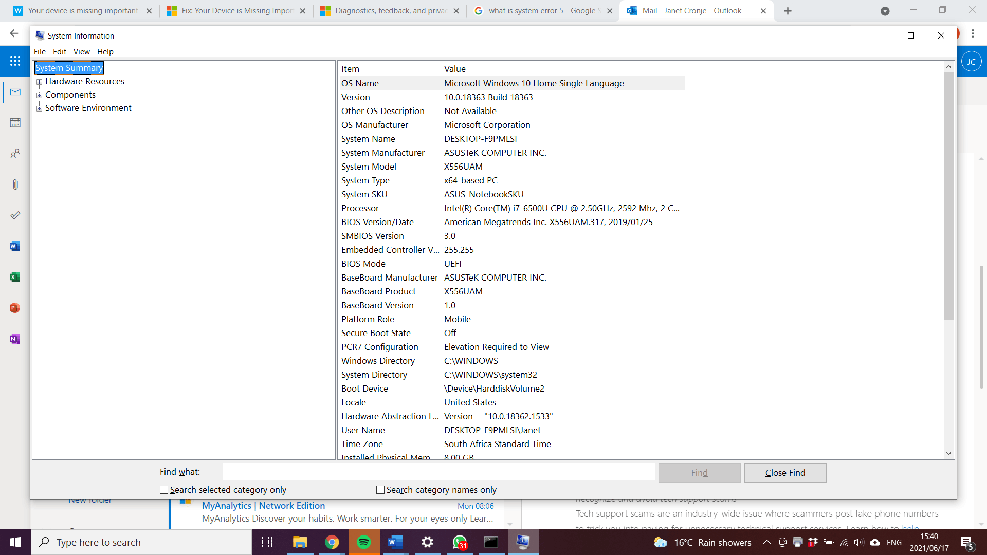

    Sadly I still can not get it updated. Throughout the day I've had it do many different little updates but it now seems like it wants to stop with this error: 0x8007002 - 0x20007 The Installation Failed in the SAFE_OS phase with an error during INSTALL_DRIVERS operation. I've preformed what was suggested several times. And I've used the Media Creation Tool and I don't think the issue is with the download. It seems to download fine. On the process of the multiple restarts is when the error occurs. I've check the drivers and they all seem to be fine - now. They weren't there was one that was an issue and seems to have come from blue tooth but I took care of that one. And even though the error points to a driver issue my seem to be alright.

    DebraK1 - have you found anything that has worked yet? I've been troubleshooting this for two weeks and still have not found the solution. My system indicates there is no corruption but I can not get past "your device is missing important security & quality fixes". I can't identify what security & quality fixes are missing and I can't get Windows 10 to do an update.
