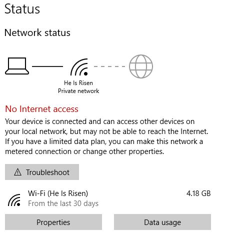

I am running on Windows 10 Enterprise, Version 2004, OS Build 19041.264.
I recently changed to the Windows Insider Program and updated Windows. In the taskbar, the Wi-Fi icon shows No Internet Access, but I have a stable internet connection wirelessly (Ex: I can browse the internet, ping IP Addresses, etc.). Another problem is when I try to open Cortana it also says that I have no internet connection (By the way, I can also open Microsoft's website).
As I know Windows checks internet connectivity with this URL: http://msftconnecttest.com/connecttest.txt. But this gives Error 404, File Not Found. Maybe it is because of this?
If you know the problem or an answer, please help. Thanks!

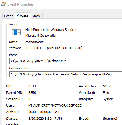

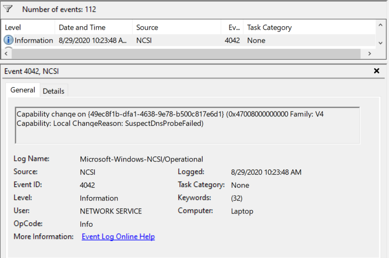

    I've gone through my entire Windows Event Viewer and have figured out the event that seems to most likely correspond to the drop in network connection:
    EnableActiveProbing is set to '1' in the Registry (and was before I checked it). I'm not entirely sure what this means but it does seem to be the first symptom.

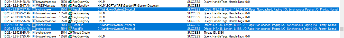

    I have since run Sysinternals Process Monitor and have been able to capture the disconnection. It may be unrelated but looks like there are three separate ReadFile's with "C:\Windows\System32\ncsi.dll". These 3 events are the ONLY times that the "ncsi.dll" shows up in the "Path" column.
    This is the detail from the first ReadFile Event selected above.
    This is certainly not my area of expertise but more of an update to anyone @Microsoft that may be looking at this that I have a Windows Event Log EVTX file and Procmon PML file of it happening on my Windows 10 Home v2004 Dell Inspiron 7591 if they would like it for troubleshooting.
