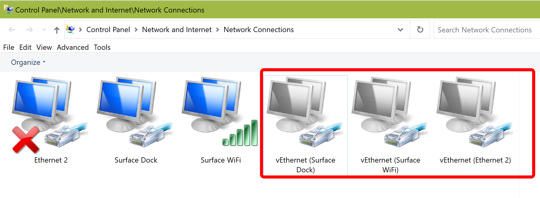

    2020-08-10T17:08:26+00:00
    I'm a network engineer and so I'm very familiar with the network settings on my own devices.
    (In fact, my avatar shows me working on a network rack)
    After receiving the update that caused this issue, I noticed that there were several new network connections added to my device.
    The new connections had names that started with "v".
    I DISABLED these new connections and now the tray network icon is normal and I can connect to Windows Store (a good way to test to see if you can connect to MS services)
    THAT'S ALL I DID.
    In the image below, the grayed out icons have been disabled by me.
    2020-08-15T12:55:50+00:00
    Thanks! This helped me fix the problem.
