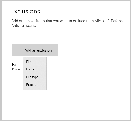

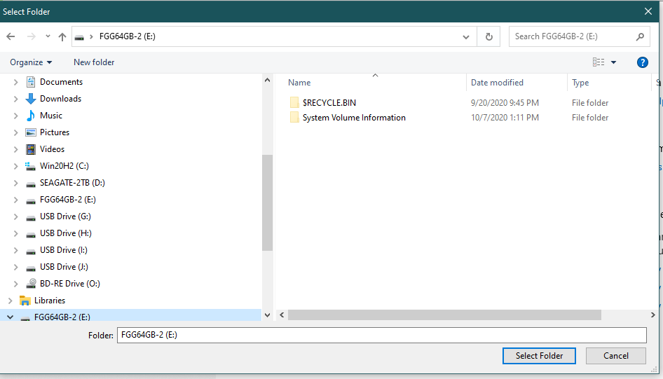

    Does not work. Cannot even add the drive since it is not a folder or file or process or file type. Those are the only options. When you try to add the entire drive, it does nothing. Nothing gets selected even if I type it in manually and press enter or select.
    @BWX,
    Looks like you did not understand how to add it:
    It is the root folder of the drive.
    E:\
    F:\
    or other drives...
    In order to add to the exclusion list, the drive must be inserted, you add a Folder then you select the drive you want to exclude and click on Select Folder and it will add it to the list.
    Then you just reboot and you are done.
    See screen shots below for adding Folder E:\
    (  F:\ was already added in this sample)
