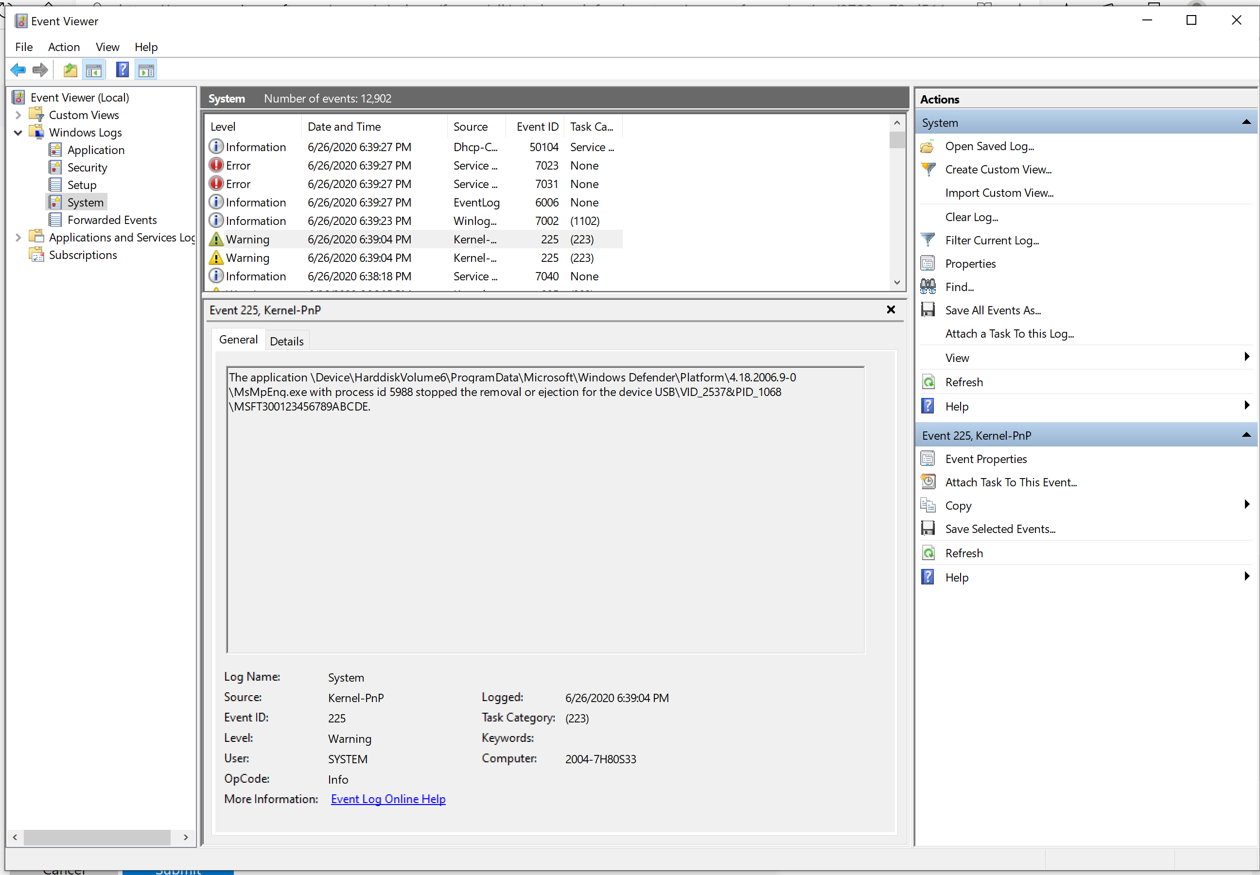

After uninstalling Norton (as it came preinstalled after on my computer) I started to experience an issue, whenever I would try to eject my hard drive I would get an error, after looking in event viewer I saw an error talking about how msmpeng.exe was stopping it from ejecting. After researching I found out that this task was windows defender.
However I have tried everything to stop this from happening to no avail, Ive gone into its settings to turn it off and yet it still runs in the background still blocking be from ejecting my hard drive, attempting to close msmpeng.exe in task manager gives me an error that I dont have permission (with no way to change this) I have then followed guides about going into edit to make a file called disablelivespywareprotection (something like that) and now Im out of answers, Am I now forced to just unplug it unsafely or something? please help

The only way that worked for me is by excluding the root Folder of the external drive in defender.

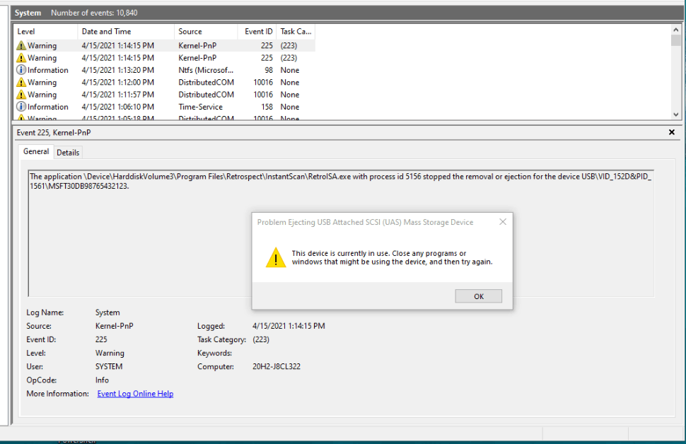

Keep in mind that recently, besides MsMpEng.exe there was another possible cause for people that use INTEL DSA, DSAService (32 bit) that prevented the ejection, so we need to check the event viewer to see the message on error 225 and check for the culprit, there could be other reasons too.
Not sure if they fixed that DSA problem in 19042.928, it was reported in FBH.
