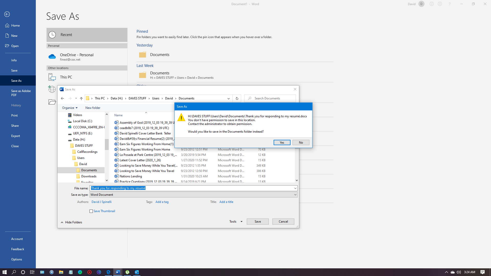

    2020-05-27T10:40:48+00:00
    Greg?  Here we go again...  This time, I'm in word and about to save file:
    It is getting ridiculous...  You are the man for the job!  Please help me.

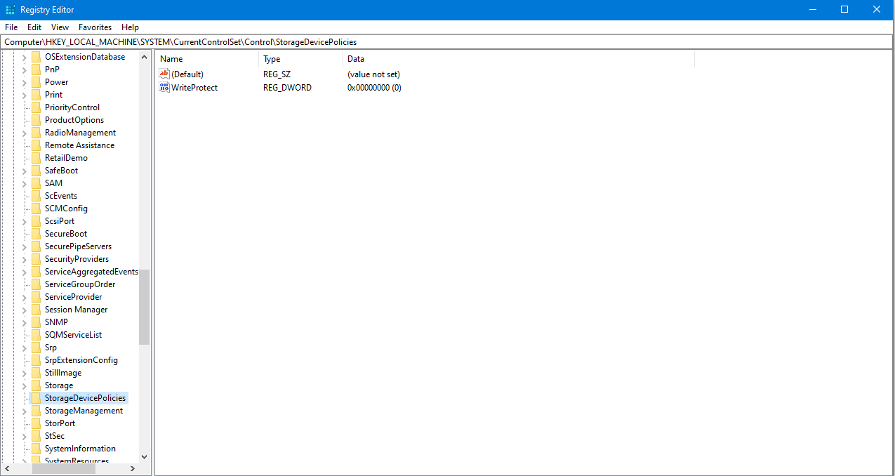

    2020-05-08T07:59:26+00:00
    Yes I can, after I rebooted.  Thank you!  Nevertheless, now I can't get my email...………….  I don't want to bother you again; so I'm reinstalling Office.  I hope it works.  Stay tuned...……………………...………………………….
    2020-05-08T04:16:36+00:00
    Greg?  I did some checking.  In drive F. I have ReadOnly attribute; but in the security tab I have full control.  I can d/l files there.   On drive H, I have the I have the ReadOnly attribute; yet in the security tab the full control is absence.  In regedit I did what you asked and the new sequence is available in the above.  I went into explorer, got into the download folder of h and listed the property page.  I selected full control in both administrator and user.  It told me it's not allowed and canceled  the operation; however I have full control now.  Let me see if I can d/l a file...
