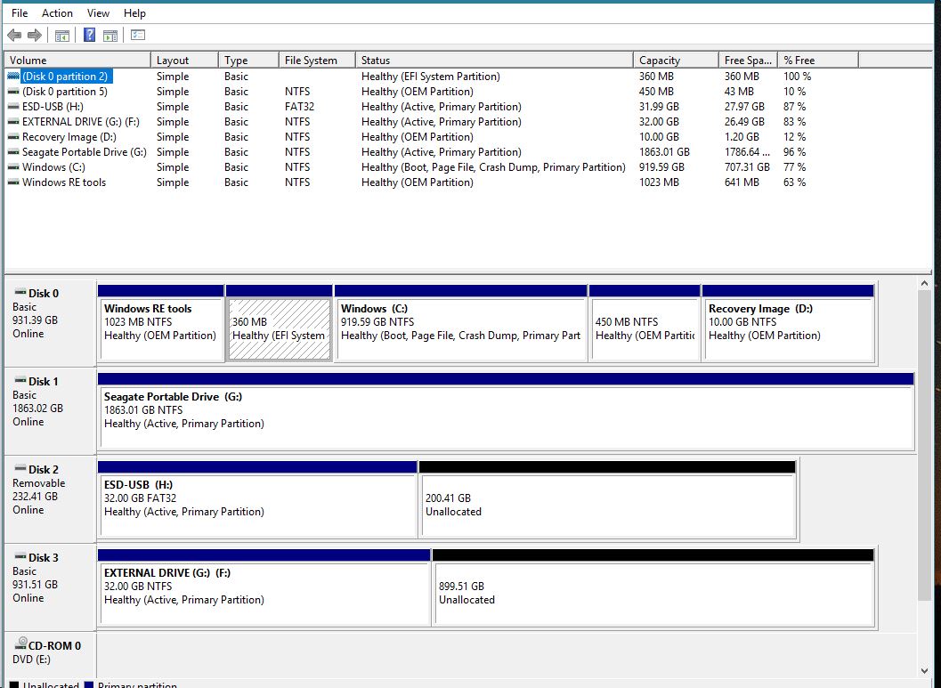

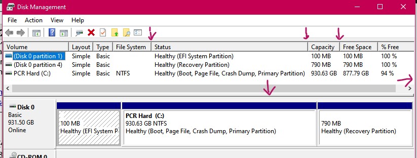

    (5) It does look like you've got a UEFI install. In that case, Windows doesn't like to see more than one EFI system partition anywhere during an upgrade. Let us see all disks & the partitions. Right-click START, & select Disk Management. Use the divider lines in the header & between the panes to pretty it up...
    2020-04-28T19:56:54+00:00
    I made a restore point, I've used them before when there was a problem but they seem to disappear when I really need them. Do I need to make a new one after using it? Maybe it was a cleanup glitch I didn't catch.
    I've  tried to update again since last night but it will take a long time. I did try the diag again and got the same information that finally posted yesterday.
    This pc had Windows 8.1 when I bought it, though the restore is for windows 7? I was told it was okay to installed 10 when it first came out though that's when I started having little issues but figured it was because 10 was new and the bugs would get worked out in time.  So the restore will be for 7 not 10 or even 8.1 as it should be, won't it will mean that I'll be further behind than I was when I bought it?  If I'm having this much trouble with downloads to add to 10 how much worse will it be to start from 7? Is this just a precaution so I have some sort of  os if all this just crashes? I have a recovery that was put in /:D back in 2014. I'll put the restore on an external drive.
