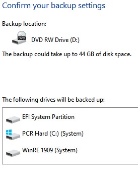

    2020-05-27T21:54:09+00:00
    I renamed the old back up "image_1909_with_1809" should I make a new one without the 1809?
    I did another dry run and it looks like it went correctly. I should the above file.

    (2) Let me see what Windows system image offers to you...
    Mine are all pre-selected & cannot be checked/unchecked. You will want EFI (it's shared). MSR doesn't show up there. The WinRE it offers or pre-selects belongs to 1809, but at least it's tiny & won't hurt 1909. Yeah, may as well make one without the 1809 partition (D:). Then name it "Messy_1909".
