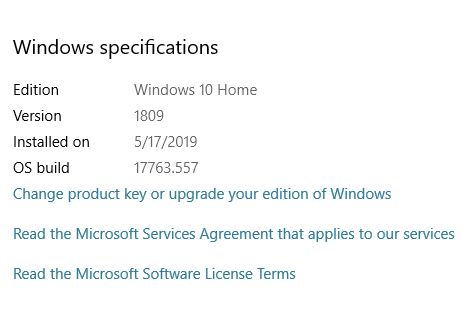

    Question - Am I suppose to be running off the USB to get into1909? Because when starting i'm given a choice as I said, one is Windows 10 and the other is Win 1909, though they both say that they're 1809 in System >About. even after doing
    BCDEdit  /Set  description  "Win 1809"
    BCDEdit  /Set  {default}  description  "Win 1909"
    I thought to click the above change product key or upgrade your edition of windows but I don't know if that was going to mess something up. So I didn't.

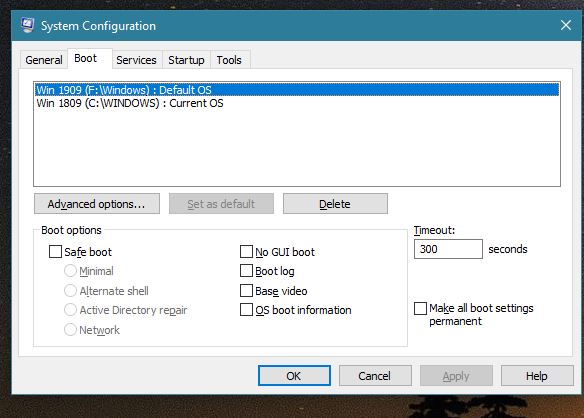

    (b) Let me see a BCDEdit & an MSConfg again.
    (2) Are you still seeing volume 4 & 5 at boot now?
    (3) And 5 is on top, & it leads to 1909?
    (4) And this is the boot option screen -- or does it look different?
    Too bad I still don't quite really recall that, & I can't easily find mention of it on the NET. Too bad I suggested the second one would probably be 1909, but it was the first -- volume 5. I'm thinking we should undo this dual boot & try it again. I'm thinking -- by booting into 1809 (volume 4) before the process was done -- things got messed up & may still be incomplete.
    This time, we'll stick with the top one (volume 5) all the way through the complete install process. Let me see those items, then I'll post how to undo it.

    1b) MSConfig
    not sure if this is what you wanted
    I haven't rebooted from the USB again yet, I wasn't sure what it would mess up if anything but I'll give it a try and let you know the rest.
