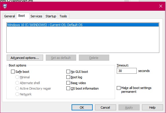

    (b) Type MSConfg into Search, & show a picture of the Boot tab...

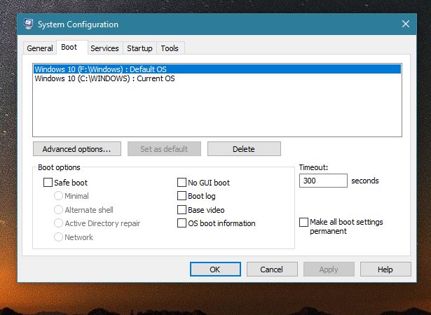

    3b) MSCONFIG

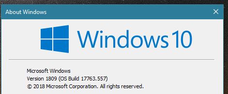

    4)It still says I have 1809
    a) Maybe I should have picked 5 instead of 4?
