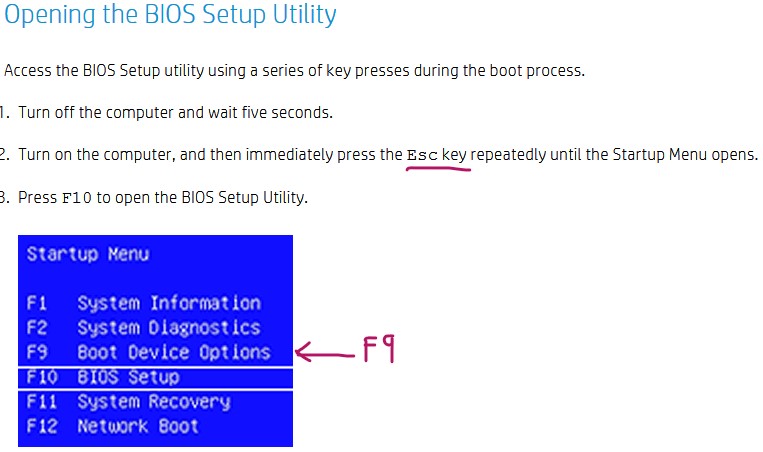

    (6) Practice a boot to your 1909 Installation USB drive through the BIOS boot menu.
    (a) Plug it in, then reboot.
    (b) Immediately press ESC repeatedly for the Startup Menu.
    (c) Press F9 at that screen for the "Boot Device Options" screen.
         I think it then shows you boot options --  is the USB drive shown?
    (d) Then select it to boot to the 1909 Installation USB drive.
    That's just a dry run to see whether you can get there. If so, back out, you're all set.
    OK, practice that, & answer the questions. Then I'll write-up how to do the dual boot.

    6c)  "Is the USB drive shown? " Yes, sandisk device is there. I didn't enter into it in case it started something I wasn't suppose to do. All did as you asked.

    (4) "Yes, sandisk device is there"
    That's it, then. (If two were there, you'd choose the one that said "UEFI".)
    (a) Select it to boot to the 1909 Installation USB drive. (You've been there before.)
