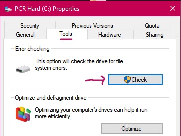

    (c) Maybe do the Windows version instead, which is much, much quicker. I've read - if it finds something serious - it will reboot automatically & do the CHKDSK. Right-click C: in File Explorer, & select Properties. Then,****at the Tools tab, click Check...

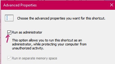

    (2) Regarding Autoruns, did you extract Autoruns.zip into a folder -- not just open it...?...
    Did it have all the stuff in your folder that I showed in mine? Did you right-click Autoruns64.exe & make a shortcut onto the Desktop? Then, right-click the shortcut, select Properties, click the Advanced button, & put a check into "Run as Administrator"...
    Then try the shortcut. I hope that makes a difference.

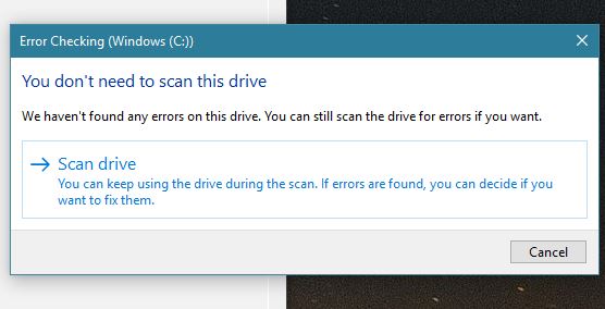

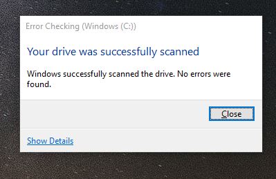

    1. a, b, c) I got CHKDSK /R to run through, well you did, then goofed -typed exit thinking to open notepad and paste it. Shouldn't have done that. But I did read it first and it said there wasn't any bad things in any of the 5 stages. It did take a while but I believe I had run it years ago before all of this started.  I ran windows version first  gave me this
    but I scanned it anyway. Said it was good.![](https://learn-attachment.microsoft.com/api/attachments/4d87a794-3a59-467d-835a-484dba0fc81d?platform=QnA

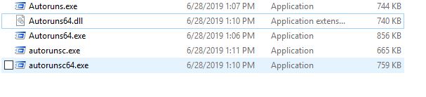

    1. I "extracted here" for autorun.zip (on desktop) and then put everything in a folder called autorun on the desktop. Have put a shortcut with run as administrator on desktop but it still runs fast (not as fast as yesterday but too fast to read) and then shuts off. this is what was extracted.

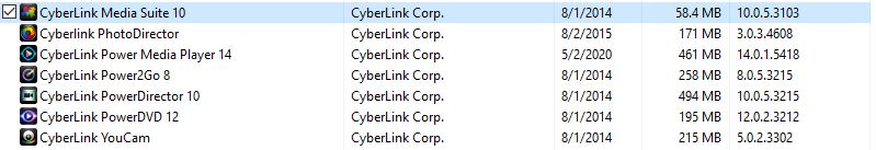

    3) This is all the cyberlink programs.
    I've uninstalled 14 now wondered if they should all go.

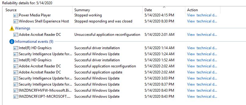

    Many of the other Xs in Reliability History are stopped working. Programs stopped responding, my graphic programs do that a lot so I uninstalled my grapic driver software and reinstalled it last night, since I read that's sometimes the problem, but haven't had time to see if it helped or not. Windows failed to start because of a problem with the hard disk one day ad one minute later PowerDVD14Agent.exe stopped working.
    Reliability History for today so far. Apparently security updates are still able to install without a fit and I don't even use Bing or Zune Music but they get through.
    Not sure how media player stopped working even after it was uninstalled- I did look and it was gone in the Settings>Programs>Uninstall
    Critical event for Windows Shell Experience Host >Technical details.

    (1) Looks like your HDD is fine. That's one big good thing.
    (2) Are you showing the full contents of that Autoruns folder? It's missing two items that are in mine, namely Autoruns.chm & Eula.txt. The first provides Help screens. The second might need to be present for Autoruns to run, although I can't quite recall whether it ever was presented. Other than that, the files look fine. Delete the folder & the shortcut. Then, extract again & make a new shortcut.
    Although what you did should have worked, I would find somewhere else to extract the files to. Maybe, make a folder in "C:\Program Files" named "SysInternals". Move Autoruns.zip into that folder, & do the extract there. Does it give you all 7 files? Then, right-click Autoruns64.exe, & put the shortcut on the Desktop, etc.
    (3) If you can bear to part with them -- absolutely, uninstall all the Cyberlink items. I count 7 of them left, & that will be 7 fewer possible causes of the difficulties. The Power Media Player hopefully disappears by the time you reach bottom. It could be part of CyberLink Media Suite 10.

    (5) BING & Zune are Microsoft Store apps. They come in a different way than the Windows updates. It's good they are coming in & the Defender updates too. We really need to get Windows update working, though.
    (6) I had a "Critical event for Windows Shell Experience Host" too once/twice. It self-corrected, meaning it hasn't shown up for quite a while.
