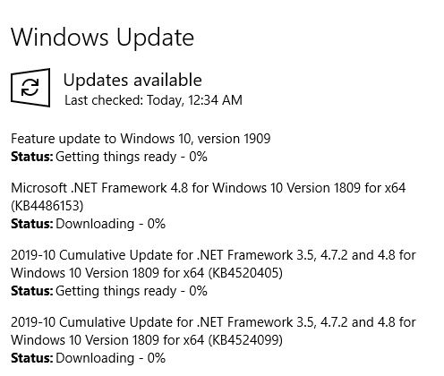

    (2) How do things look at "START, Settings, Update & Security, Windows Update"? Is there any message there? Anything waiting to come in?

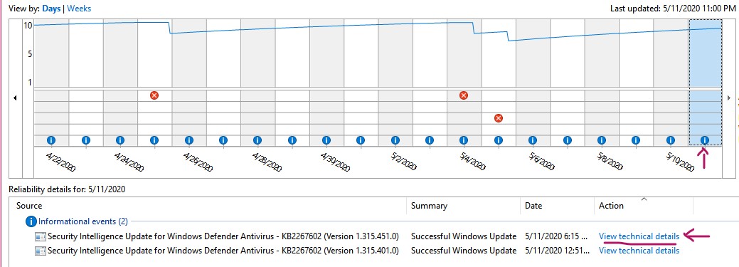

    (3) Let's see any message in Reliability History (type into Search). Click the day (5/11/2020), then click "View technical details" for any item with a red X...

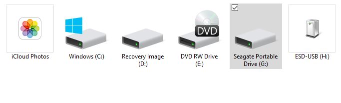

    This is what File Explorer says (minus my seagate)![](https://learn-attachment.microsoft.com/api/attachments/97533efa-6241-48ed-87d1-b7fb7bc61ec0?platform=QnA

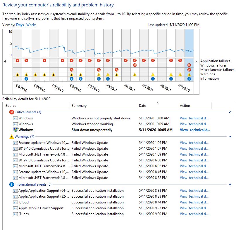

    Reliability looks bad.
    The shutdown was because everything froze.
    Don't know if you want to see every tech error.

    (1) Those DiskPart's look OK to me. The 1809 & 1909 environments are getting the same letters. C & D remain as in Windows, & the empty Win 8.1 Recovery partition (Windows RE) gets no letter. Though the 1809 environment is adding an extra letter (H) to the 1809 Recovery partition (492 MB), at least it doesn't muss any of the other letters. I'm pretty sure it didn't happen to me when mine was 1809. But it happens to me now that it is 1909. It appears to afflict our internal environments, but not the external ones.
    I guess the letters are not the problem. But it sure looked like it might have been before.

    (3) Yeah, Reliability History looks pretty bad. Copy/paste the details of those 3 red X's.

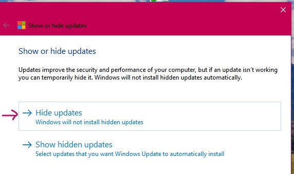

    (4) There is too much going on at Windows Update. It could be why your internet is slow. We should have checked that before trying the upgrade. I'm sorry I didn't think of it. Download WUShowHide...
    https://support.microsoft.com/en-us/help/3183922/how-to-temporarily-prevent-a-windows-update-from-reinstalling-in-windo
    WUShowHide

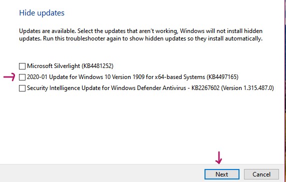

    It looks like 1909 has started coming in at Windows Update again. See whether you can block it with WUShowHide. If it has come too far, you might have to let it complete & fail. Then catch it when it starts to download again.
    (a) We want to stop the upgrade attempts until after 1809 is fully updated with those NET Framework updates & any others that may be coming.
    (b) Maybe even block 2 NET framework updates so that one at a time comes in.
    To block them, click Hide Updates, put a check into it, then click next. To unblock them, click Show Hidden Updates.
    It looks like I'm soon to get KB4497165. It hasn't shown up at Windows Update yet.
