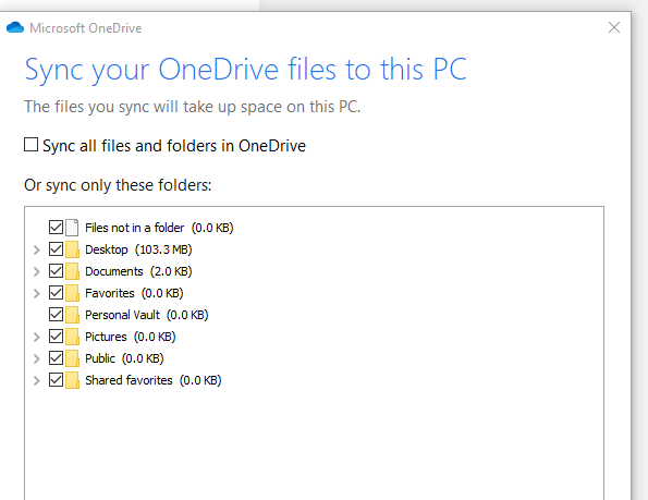

    I'd like to hear more about that. A clean install should behave well with OneDrive. But I only did it once a few years ago & didn't pay much attention seeing no problem. I think I lost no files & definitively did not get triplicates. Right-click OneDrive, select Settings.
    (a) At the Account tab, is there still just one account?
    (b) Click the Choose Folders button -- are there duplicate folders
         or even differently named folders that you know hold the same files?
    (c) Did you add folders to OneDrive prior to the clean install -- which?
    (d) At the About tab, does it say its version is Version 2020 (Build 20.064.0329.0008)?

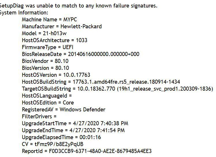

    (c) SetupDiag hopefully will no longer be necessary, can always be downloaded again, but maybe keep it till after 2004 has come in well.

    ssetupDiag
