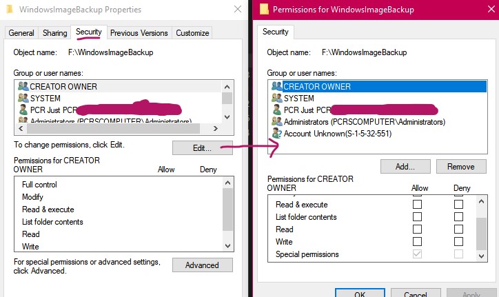

    (1) Uh-oh -- are you trying to move WindowsImageBackup? It needs to be...
    (a) in the root folder (right after the drive letter) for the restore process to even see it.
    (b) on the original drive it was on when an image was made, or that image won't really restore properly.
    So -- if you really want a duplicate -- make the same image twice, once on each drive!
    (2) But I don't get that error message when I copy/paste WindowsImageBackup. Here are my permissions. The top two have only Special Permissions checked. The other three have everything except Special Permissions checked...
    (a) Maybe it is because the folder was created when you were in the dual boot. Did you keep the same user name for the 2nd clean install?
    (b) Maybe it is because you didn't open WindowsImageBackup (&/or each sub-folder inside it) to get permanent permissions.

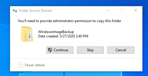

    Found a access denied folder.
    I click continue each time and it goes through. Seems rather useless if it doesn't really stop someone from doing it.
