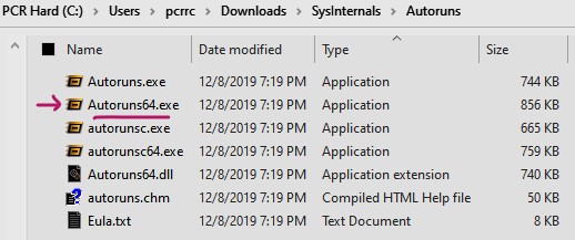

    Autoruns, above, doesn't require a formal installation. But it has a 32- & a 64-bit version. Either will run for us. It downloads as "Autoruns.zip". Extract it to a folder of your choice...
    Both versions are inside. Put a shortcut to Autoruns64.exe onto the Desktop to run the 64-bit version. Then you may then set the shortcut to automatically run as an Administrator to avoid its pesky question each time you run it.
