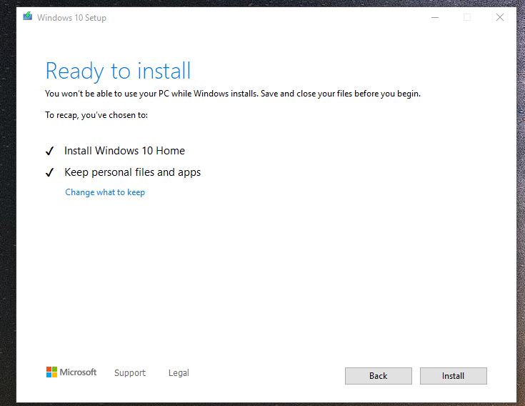

I tried reinstalling 10 with keeping my programs, but the internet is too slow to get it to work even after several days of trying. I can't fresh install even if I had my disk with me. Many of my programs can't be replaced well not by me.
