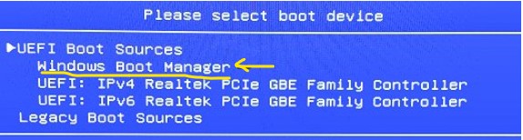

    (2) Well, OMG, at your computer's site, I'm getting led by the nose from article to article starting with this one...
    https://support.hp.com/us-en/product/hp-pavilion-21-h000-touchsmart-all-in-one-desktop-pc-series/6528604/model/6529764/document/c03801890
    HP PCs and Tablets - About UEFI and the Startup Menu
    It says, your Boot Device Options menu normally should include the Windows Boot Manager (whether or not a USB flash drive is plugged in)...
    It makes me wonder again whether your HDD is getting detected. Maybe the System Diagnostics reported no error because it, too, found no HDD. Here is an article that should settle the issue...
    https://support.hp.com/us-en/document/c06298595
    HP Desktop PCs - Advanced Startup Troubleshooting (Windows 10, 8)
    Do the things in the section "Check if the hard drive is detected in BIOS". Then do either "Hard drive is not detected in BIOS" or "Hard drive is detected in BIOS, but computer does not start".
