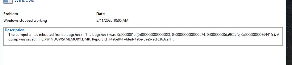

(2) I don't like that bugcheck. Do you get a lot of them? Those are blue screen errors. There are many threads on bugchecks that are really sad to look at. They end up checking various hardware components one after the other, swapping RAM chips, installing fans & blowing out dust bunnies. But it could just be software as well.

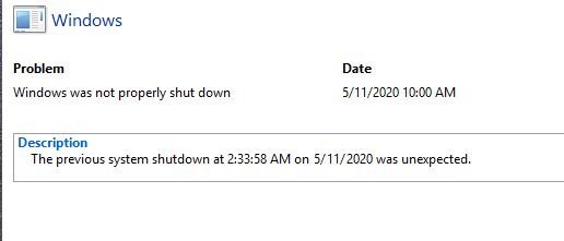

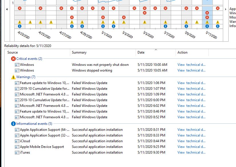

    3.  I see two X for 5/11 and 7 warnings,![](https://learn-attachment.microsoft.com/api/attachments/289012bd-2dfe-4013-8024-6361a98723fb?platform=QnA
     Here are the technical details of the critical events.

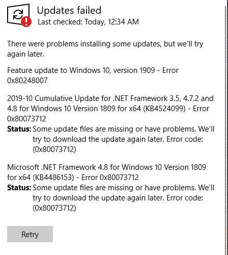

    4 (b) Just tried and failed installing Microsoft .NET Framework 4.8 for Windows 10 Version 1809 for x64 (KB4486153) again Message -Some update files are missing or have problems. We'll try to download the update again later. Error code: (0x80073712)

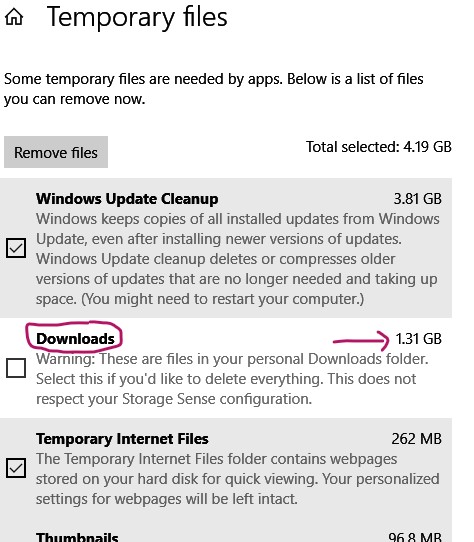

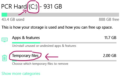

    (a) "didn't see just Temporary Files category"
    Oops, that's right, in 1809, at "START, Settings, System, Storage", you have to click the (C:) drive to open the categories list. Then click Temporary Files to see the various items. In 1909, the categories are on the same page...
    In the items list, careful you don't delete your Downloads. Those are better examined individually at "right-click File Explorer, Downloads" (good that you make backups). I just took in a new quality update (OS Build) & got a big Windows Update Cleanup to do. I usually like to delete it just before making Windows system image backup...
    (b) "I went to Storage and then into Free up space now"
    In 1909, you get "Configure Storage Sense or run it now". I have it set to never delete my Downloads...

    (3) "Which 3 red X's?"
    I meant the 3 showing under "critical events" in the bottom pane of your picture of 5/11/2020.

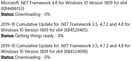

    (b) Then, I'd want these one at a time...
    I hope we won't have to resort to the Microsoft Update Catalog.

    (2a)  I went to Storage and then into Free up space now - didn't see just Temporary Files category. After using it on Windows upgrade log files, it lightened the file icons though it didn't trash them. I found the delete previous versions of windows in Change how we free up space automatically>Free up space now. After they're opened I move wanted downloads to an external just in case of a crash. Do you want before and after images?
    (2b)I've had to download the AVG remover since just uninstall isn't getting rid of all of it. I have to run it again but I've had AVG turned off during all of this troubleshooting and when every I try to install anything, same with Malwarebytes.
    (3) Which 3 red X's? I see only two in any column.  Do you mean the ones in the blue column at the end?
