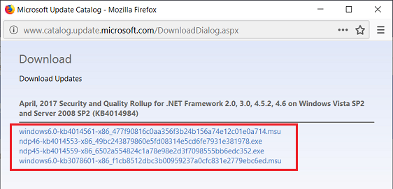

    Going back to the missing trust certificate problem you both had when Windows Update tried to install KB4014984 (Security and Quality Rollup for .NET Framework 2.0, 3.0, 4.5.2, 4.6 on Windows Vista SP2 and Server 2008 SP2: April 11, 2017) during your clean reinstall of Vista SP2, can you both clarify something for me?
    Is the .NET Framework v4.5.2 and/or v4.6 currently installed, and if so did you install either of these .NET Frameworks manually (e.g. by running the standalone v4.5.2 installer NDP452-KB2901907-x86-x64-AllOS-ENU.exe from https://www.microsoft.com/en-ca/do.nload/details.aspx?id=42642) or were they only installed by Windows Update as an optional update(s)?
    And if you tried a manual installation of KB4014984 (which the title of this thread suggests) did you install all four standalone installers listed for this update on the Microsoft Update Catalog at https://www.catalog.update.microsoft.com/Search.aspx?q=KB4014984 after the Download button is clicked?
    According to the Microsoft support article Security Update Deployment Information: April 11, 2017 the NDP45-KB4014559-xxx installers (both the x86 and x64 versions) are required for .NET Framework v4.5.2, while the NDP46-KB4014559xxx installers (both the x86 and x64 versions) are required for .NET Framework v4.6.  I'm beginning to wonder now if those NDP45 and NDP46 installers add the missing trust certificates required to run newer .NET Frameworks like v4.5.2 and v4.6 on a Vista SP2 machine.

    The problem that both Peter and I were having with the Windows update and the .net April 2017 Security and Quality rollup absolutely was the missing Microsoft Root Certificate Authority 2011 root certificate.  Once this certificate was properly installed, BOTH the Windows update installation and the use of the manual updates above worked fine.  As I discussed in an earlier post on this thread, the "command line" installation method for this certificate worked a lot better than simply importing the certificate into the Trusted Root Certification Authorities tab in the control panel.  When the command line procedure was used to install the root certificate, both Windows update and the stand alone installers could update the .net framework with the April 2017 rollup.  When the "import certifcate" button was used to bring this certificate into the Trusted Root Certification Authorities tab, the stand alone installers worked but Windows update did not.
    As you probably know, .net framework 4.6 is an update for .net framework 4.5.2.  The last version of .net 4 for Windows Vista available through Windows update is .net 4.5.2.  The .net 4.6 is available for Windows Vista, but must be manually downloaded from the Windows Update catalog and installed.  With regards to the 4 stand alone updates above for the April 2017 rollup, all 4 are not needed.  The Windows6.0-kb4014561-x86 update is an update for .net framework 2.0 and needs to be installed.  As far as the ndp installers,  these update .net 4 and only one is needed depending on the version of .net 4 installed.  The ndp45 file is for .net 4.5.2 and will not work if .net 4.6 is installed, and vice-versa for the ndp46 updater.  I am not sure what the last file, Windows6.0-kb3078601-x86(etc.) does, except that it is an update from 2015.  When I tried to install it, I got a message indicating that it was already installed (presumably by Windows update.)  I did not see any point in investigating it further.  By the way, the Window6.0-kb4014561 installed fine prior to installing the 2011 Microsoft Root Certificate, but the ndp installers would not run without it.
