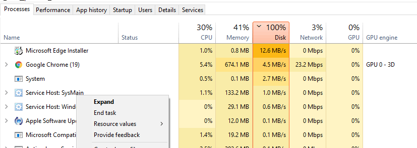

    Here it is sorted on disk usage - It is mostly microsoft **** that I cannot turen off. It was over 50MBs at 100% usage just before I did this capture
    It does not matter what the disk bandwidth is, the usage is always 100%
    When the Microsoft apps quit using the BW, then the disk usage goes below 100% - see that google chrome is now at the top of the list:
    The problem is it took 10 minutes foir the disk usage to drop below 100%. The Disk usage does not follow the actual bandwidth.
    Above usage was 86% at 3.5 MBs
    Below usage was 52% at 8,8 MBs
    They should track

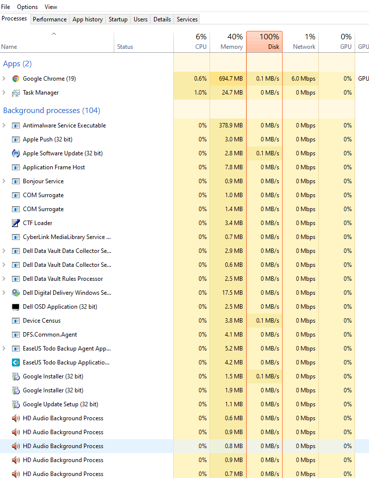

    Thank you for attaching screenshot.
    You will need to do end task of following process by Task manager. Just right click on specific process and click end task.
    1. Apple Push
    2. Apple Software Update
    3. Bonjour Service(it is related to iTunes)
    4. EaseUS todo backup application
    5. Google update setup
    6. Google installer(32 bit)
    7. Google installer(32 bit)
    Also right click on "HD Audio background process" and click on "search online". And take decision according to web solution.
    Surely your disk usage will definitely go down up-to 50-70%.
    Also attach photo as I attached. More Can I help you to reduce disk usage.
    Don't forget to attach photo as I attached. I want to see other processes that can be end task.
    Also attach photo of startup tab in task manager.
    I wish your problem solved.
    Don't hesitate to reply, I will help you.
